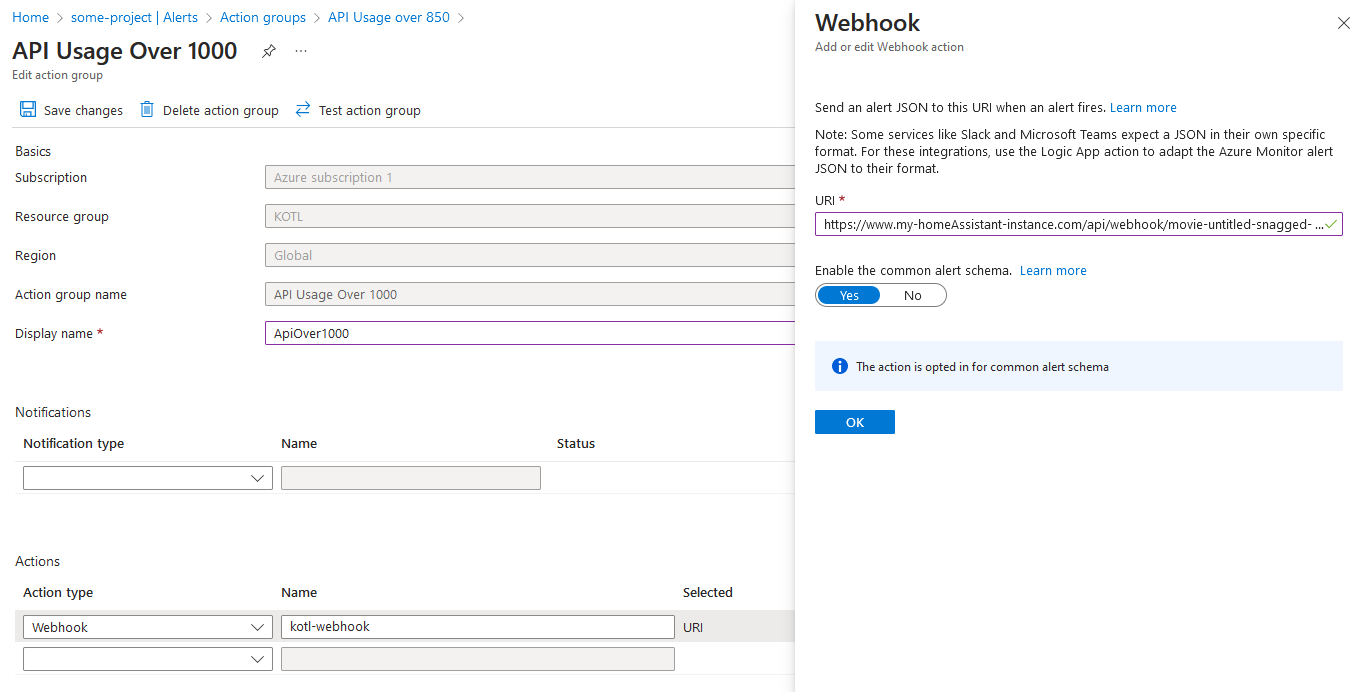

I've setup an Monitoring Webhook Alert that fires based on Metrics Usage (Ex: API Usage is > 1000). The Action group associated to this Alert Rule has been set with an endpoint
Now when I do a "Test Action Group" with any sample type, out of 9/10 times I get 403 Forbidden and worked only once. Now it just takes longer time spew out 403 response error.
I can confirm that the webhook URL is reachable and just works when I do the following from any shell
curl -X POST "https://www.my-homeAssistant-instance.com/api/webhook/movie-untitled-snagged"
Edit: Home Assistant accepts JSON data and the following is that 1/10 call's request

    The only thing I can think of; based on your screenshot, is change your Action Type to Secure Webhook. Your endpoint is https but your using http for the action group.
    I would also confirm the JSON payload being sent to the webhook to ensure the endpoint URI is able to process the payload. However, I would expect an 50x but still worth looking into.
