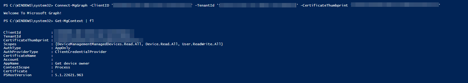

However, if I use a certificate. Then you can connect to Graph successfully. However, when I run queries, I get errors.
Example:
Connect-MgGraph -ClientID 'xxxxxx-xxxxxx-xxxxxx-xxxxxx-xxxxxx' -TenantId 'yyyyyy-yyyyyy-yyyyyy-yyyyyy-yyyyyy' -CertificateThumbprint 'zzzzzzzzzzzzzzz'
$output = Invoke-WebRequest -Method 'GET' -Uri "https://graph.microsoft.com/v1.0/deviceManagement/managedDevices"
($output.Content | ConvertFrom-Json).value | Out-GridView

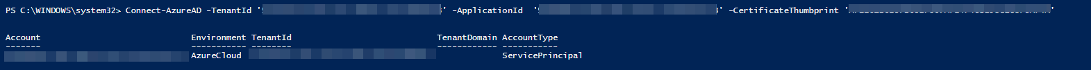

Connect-AzureAD -TenantId 'yyyyyy-yyyyyy-yyyyyy-yyyyyy-yyyyyy' -ApplicationId  'xxxxxx-xxxxxx-xxxxxx-xxxxxx-xxxxxx' -CertificateThumbprint 'zzzzzzzzzzzzzzz'
Get-AzureADUser
Get-AzureADDevice

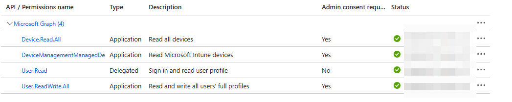

The authority is enough, but everything works with the secret, but not with the certificate. Perhaps I missed something.
