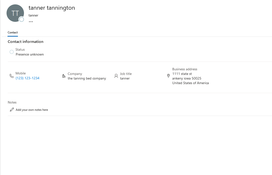

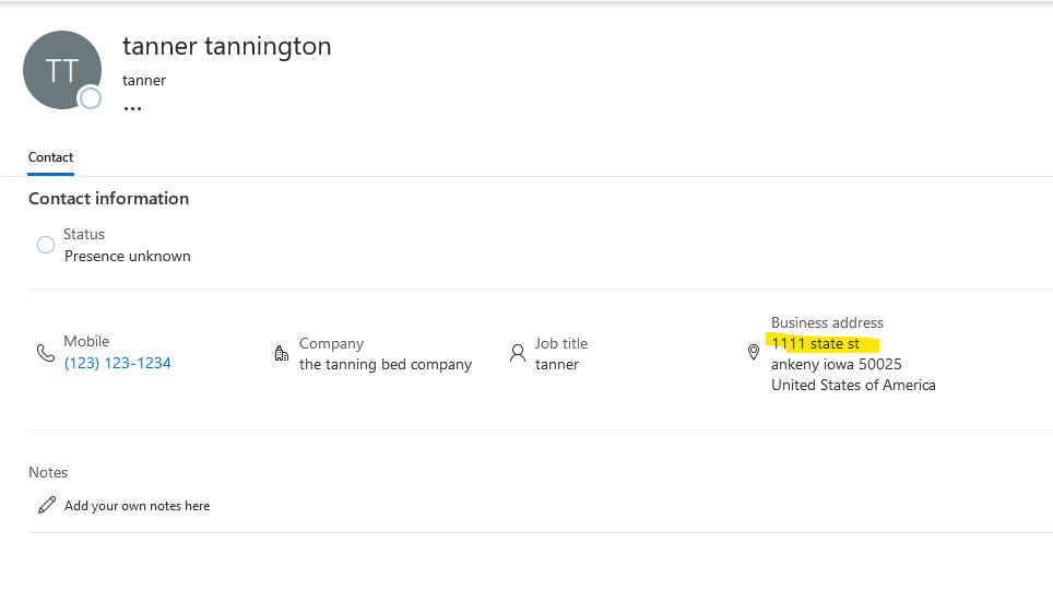

I created a Contact in Outlook and saved it. The contact is created fine (see reference picture).

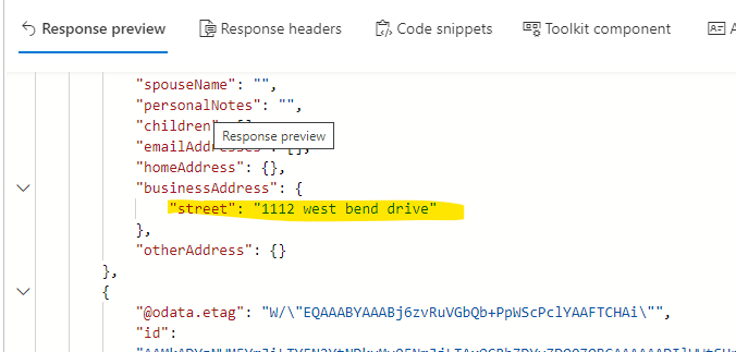

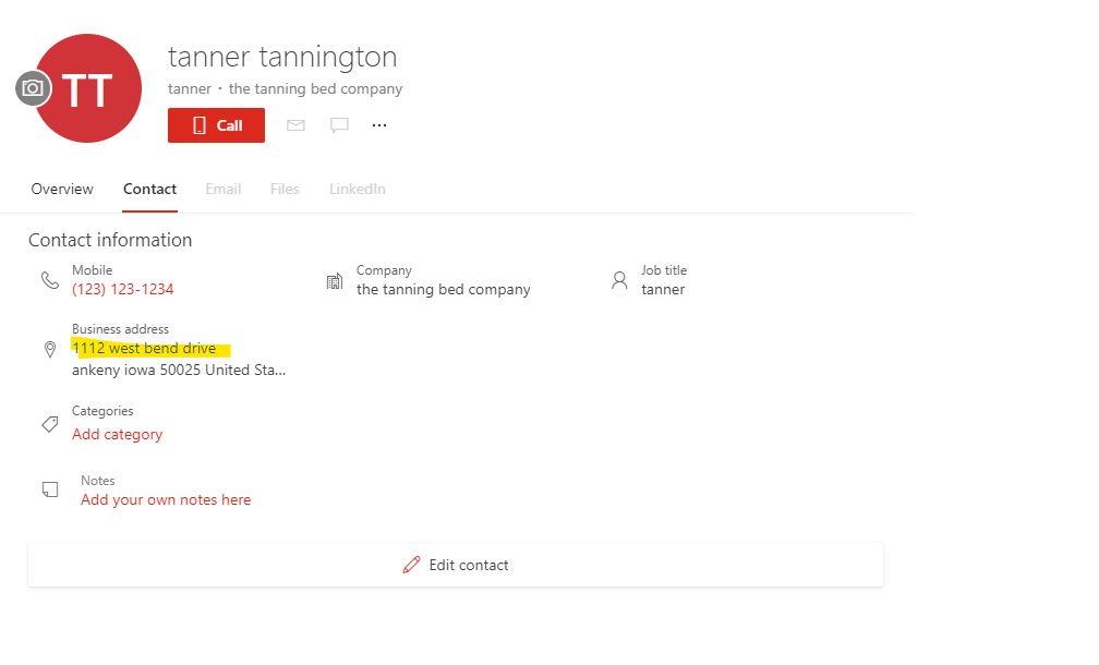

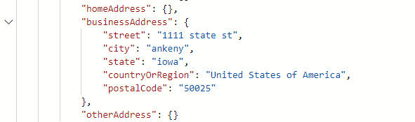

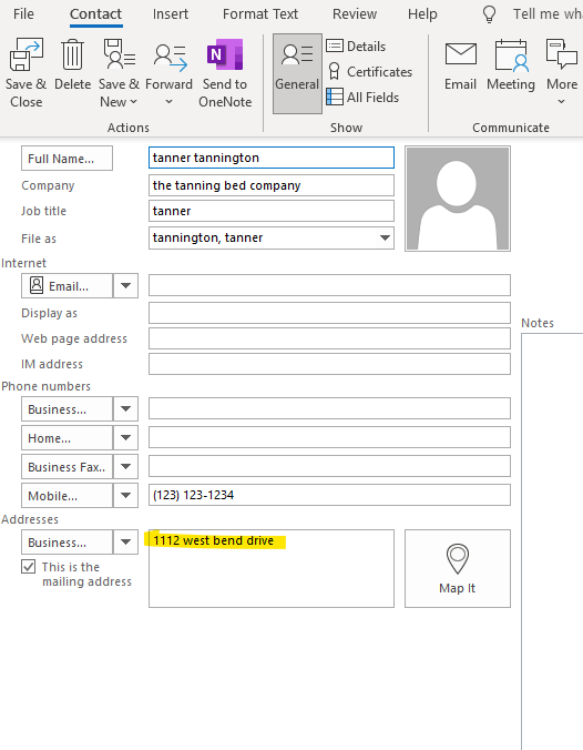

I then update the business address in Outlook by changing one field. After I call the GET, it doesn't return the complete address (see below):
Just interested in why the full info isn't being returned.

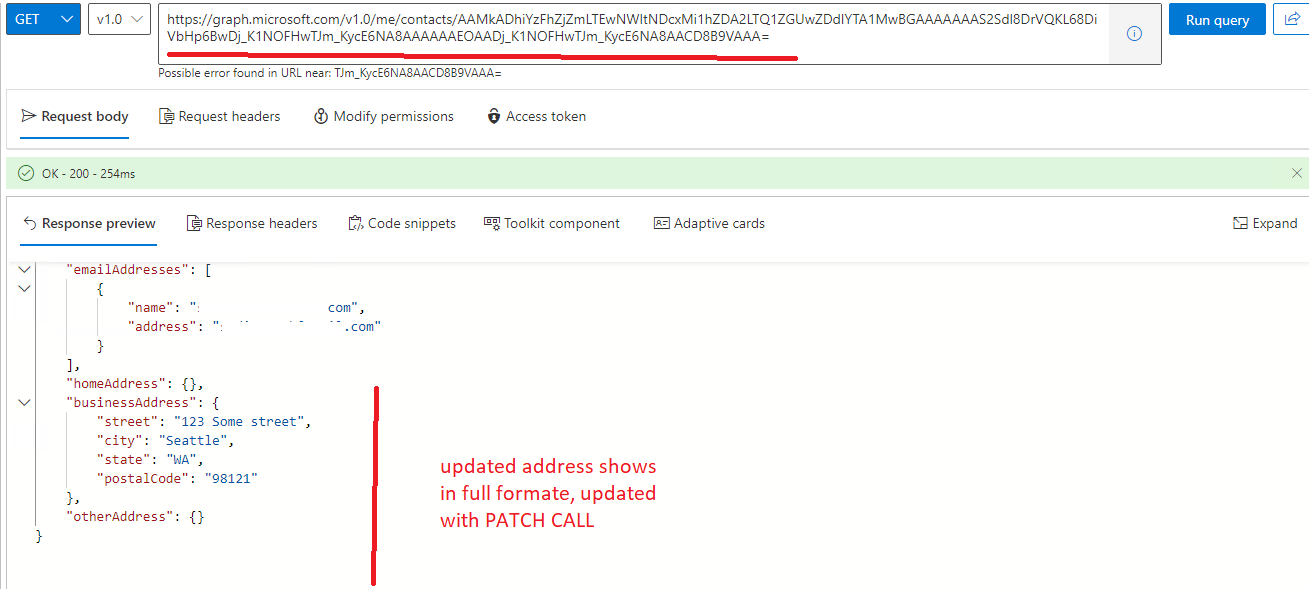

    Hello Robert Knar,
    Thank you for reaching out to this Q&A forum.
    I have done some test from my end and I was unable to reproduce the issue.
    I have updated my contact by Outlook and with PATCH API call, for both updates the Get, /me/contacts/{id} show full and correct address.

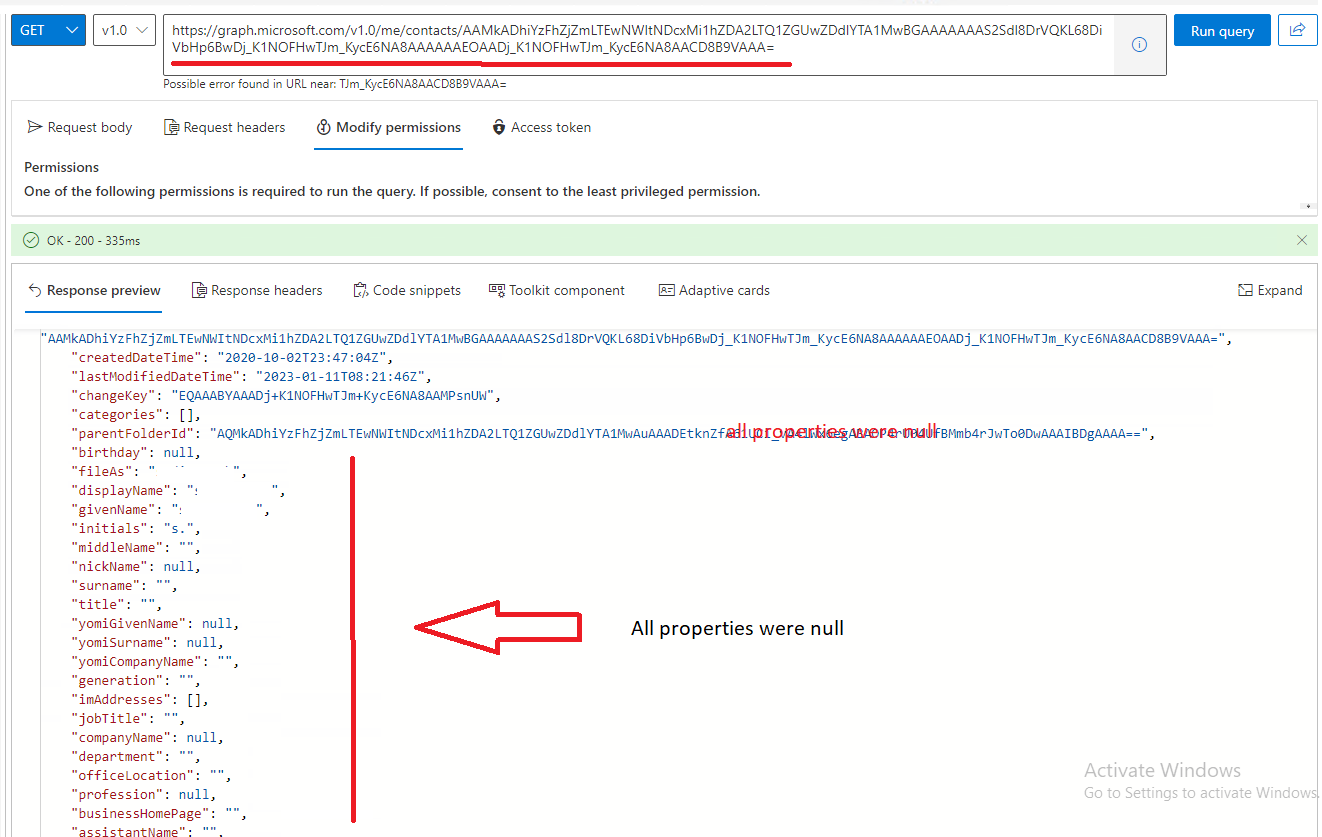

    Here is my outputs;-
    My sample contact will all null properties

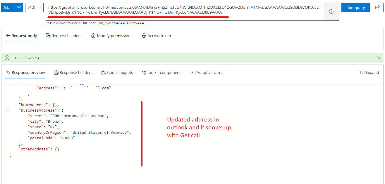

    updated business address through Outlook and it shows in Get call-

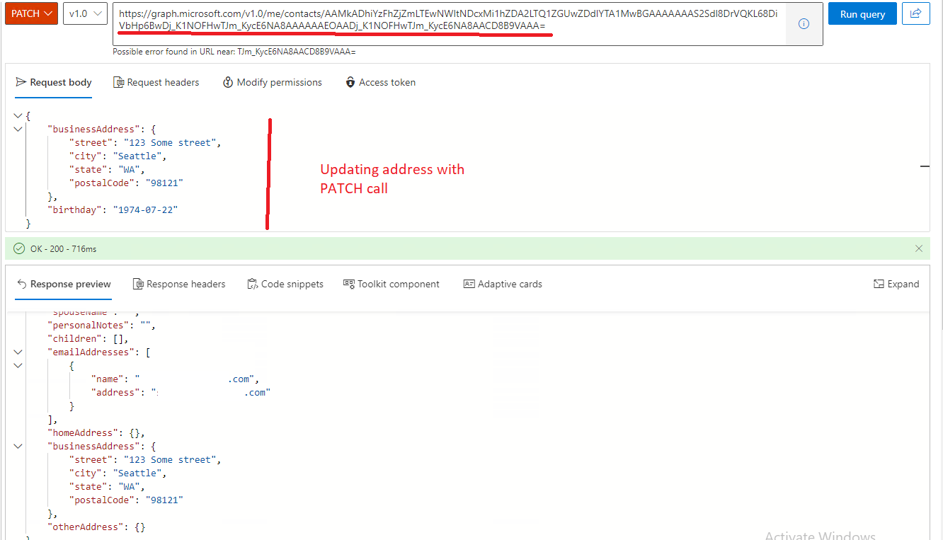

    #I updated business address through PATCH call
    #it shows in the Get call as well
    Please double check your contact ID and make sure you have updated the same contact id and calling the same id for your Get request.
