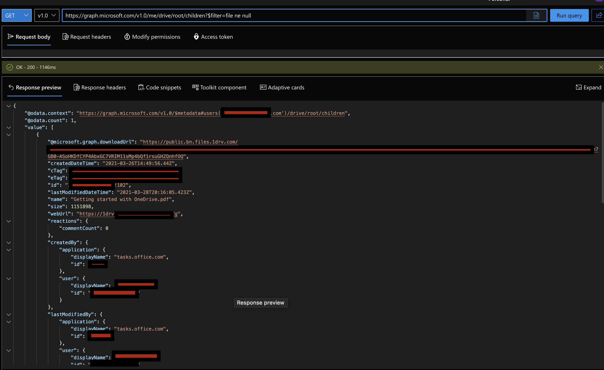

Hello, when I try to use a graph explorer with a school or work account I get an error Operation not supported.
My problem is not listed in the documentation:
https://learn.microsoft.com/en-us/onedrive/developer/rest-api/concepts/filtering-results?view=odsp-graph-online
My scopes permissions are:
  • Files.Read.All
  • User.Read
  • offline_access
My request is:
https://graph.microsoft.com/v1.0/me/drive/root/children?$filter=file ne null
My response is:
Bad request 400
"error": {
"code": "notSupported",
"message": "Operation not supported",
"innerError": {
"date": "2023-06-14T08:34:47",
"request-id": "***",
"client-request-id": "***"
But when I remove the filter from the query, it succeeds without problems. Returns everything.
Also when I try to run a query with filter with regular (personal) account, query succeeds.
I also tried to assing all the possible Files persmission scopes, but it still does not work.
My question is:
Is that correct that for work/school account it is not possible to do filtering or am I missing some specific filter-scope?

    Hello Mykyta Samovarov,
    Thanks for reaching out. Filtering is not supported for the File resource type. You can find more information on the File resource type here. I would suggest voicing your query and feedback on the Graph Feedback Forum.
