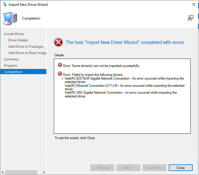

I'm in the process of setting up a new SCCM server and migrating data across from the old one using migration jobs. So far everything has migrated fine, except drivers.
When troubleshooting this, I tried to manually import an Intel Ethernet driver as a test, and even that is failing:
4225d3d2-fd22-4370-8eff-de981e46ba9b-DriverError
The DriverCatalog.log doesn't help much either:
Text
================== START CreateDriverFromINFs  =================================	DriverCatalog	16/06/2023 09:42:43	9720 (0x25F8)
INF PATH ='\\Server\Share$\Drivers\Test\Intel PCIe Ethernet Network Driver\Windows10-x64' 	DriverCatalog	16/06/2023 09:42:43	9720 (0x25F8)
INF file 1 is 'E1C65x64.inf' 	DriverCatalog	16/06/2023 09:42:43	9720 (0x25F8)
INF file 2 is 'E1D68x64.inf' 	DriverCatalog	16/06/2023 09:42:43	9720 (0x25F8)
INF file 3 is 'E1R68x64.inf' 	DriverCatalog	16/06/2023 09:42:43	9720 (0x25F8)
Initializing driver digest from '\\Server\Share$\Drivers\Test\Intel PCIe Ethernet Network Driver\Windows10-x64\E1C65x64.inf'	DriverCatalog	16/06/2023 09:42:44	9720 (0x25F8)
Successfully initialized driver digest.	DriverCatalog	16/06/2023 09:42:44	9720 (0x25F8)
Initializing driver digest from '\\Server\Share$\Drivers\Test\Intel PCIe Ethernet Network Driver\Windows10-x64\E1D68x64.inf'	DriverCatalog	16/06/2023 09:42:44	9720 (0x25F8)
Successfully initialized driver digest.	DriverCatalog	16/06/2023 09:42:45	9720 (0x25F8)
Initializing driver digest from '\\Server\Share$\Drivers\Test\Intel PCIe Ethernet Network Driver\Windows10-x64\E1R68x64.inf'	DriverCatalog	16/06/2023 09:42:45	9720 (0x25F8)
Returning 3 valid drivers .	DriverCatalog	16/06/2023 09:42:45	9720 (0x25F8)
================== END CreateDriverFromINFs  =================================	DriverCatalog	16/06/2023 09:42:45	9720 (0x25F8)
I'm struggling to find out what is causing this. I've checked all the permissions on the network share and database which are all set correcty. I know the permissions are working because other data is migrating without issue.
Has anyone seen this before?

  1. Lee O'Connor 25 Reputation points
    2023-06-16T14:46:33.04+00:00
    Ok, so I did a bit more digging on this and the issue is related to SQL Server 2022.
    To fix it, you have to change the database compatibility by running the below query in SQL Server Management Studio:
    ALTER DATABASE database_name
    SET COMPATIBILITY_LEVEL = 150
    https://learn.microsoft.com/en-us/sql/t-sql/statements/alter-database-transact-sql-compatibility-lev...
    Doing this fixed the issue for me.
