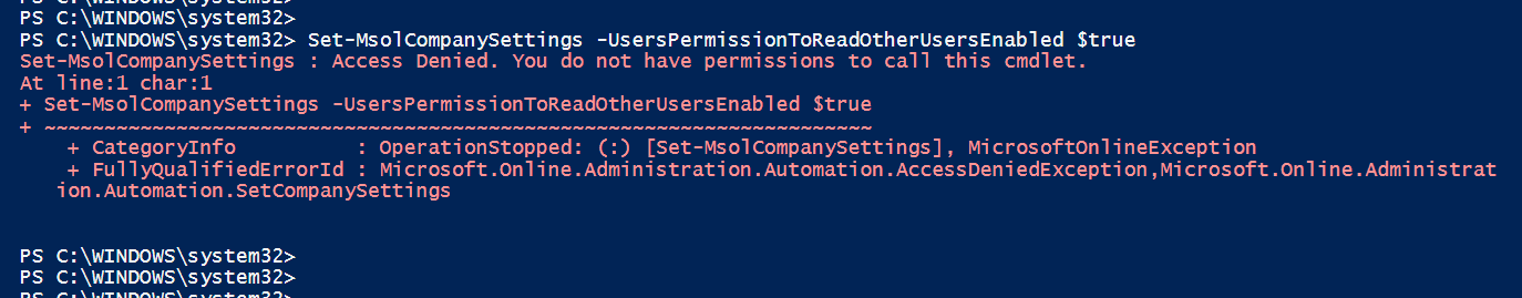

BearsBeetsBattlestar 0 Reputation points
2023-06-20T02:33:46.9933333+00:00
This appears to be a tenant wide command and no global admin account seems to be capable of undoing it with Set-MsolCompanySettings -UsersPermissionToReadOtherUsersEnabled $true. They all get access denied as one once expect given the $false setting, but we do need to undo this.

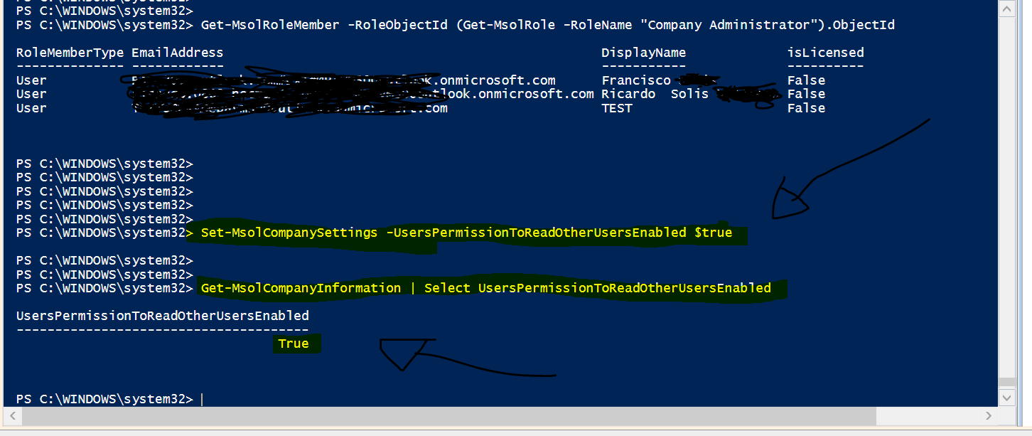

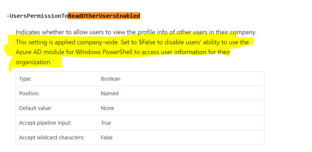

    Many thanks for holding me on this.
    I would like to ask you if it is possible to check as well as adjust the following settings at the portal level and give it another try please.
    See it below:
    Looking forward to your feedback.
    Regards!

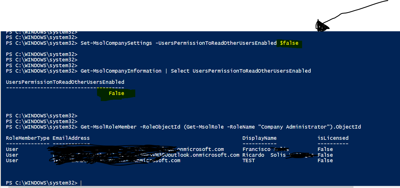

  2. risolis 8,741 Reputation points
    2023-06-23T02:05:16.08+00:00
    Hello @BearsBeetsBattlestar
    There you have the fix for your problem.
    I hope that can be useful for you.
    Looking forward to hearing from you
    Cheers,
  3. Alfredo Revilla - Upwork Top Talent | IAM SWE SWA 27,521 Reputation points Moderator
    2023-06-25T07:18:49.19+00:00
    Hello @BearsBeetsBattlestar and thanks for sharing your workaround. As a general rule we suggest to move to Microsoft Graph PowerShell SDK as a replacement for MSOnline since the latter has entered deprecation phase. Also, setting UsersPermissionToReadOtherUsersEnabled to false should only affect standard but not admin users. The error mesage and workaround signals access to the MSOnline module was disabled. Enable-AADIntTenantMsolAccess turned it on again calling the Update authorizationPolicy endpoint.
    To retrieve the authorization policy
    Connect-MgGraph -Scopes "Policy.Read.All"
    Get-MgPolicyAuthorizationPolicy
    To disable users reading other users profiles:
    Connect-MgGraph -Scopes "Policy.ReadWrite.Authorization"
    Update-MgPolicyAuthorizationPolicy -DefaultUserRolePermissions @{ AllowedToReadOtherUsers = $false}
    To re-enable MSOnline PowerShell module:
    Update-MgPolicyAuthorizationPolicy -BlockMsolPowerShell $false
    Let us know if you need additional assistance. If the answer was helpful, please accept it and rate it so that others facing a similar issue can easily find a solution.
