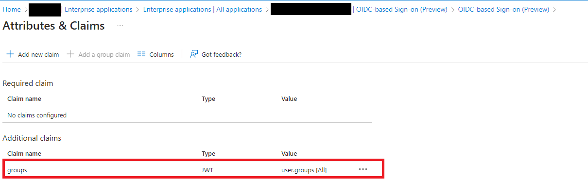

  • I have added the groups claim in the token configuration. It is configured to only contain the groups assigned to the application. I have tried the other options (All, Security Groups etc.). I have confirmed that the configuration appears correctly in the application manifest.
