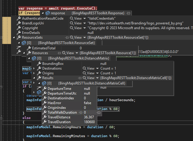

While using BingMapsRESTToolkit to calculate distance with unit as TimeUnitType.Minute the duration returned in incorrect and larger than the value return while using unit TimeUnitType.Second.
TimeUnits = TimeUnitType.Minute //returns 180600
TimeUnits = TimeUnitType.Second // returns 3010
Value returned for Second unit type seems correct. Keeping the Vehicle spec as same for both.
Shouldn't Minute values be larger that seconds value
Is this the right way to get distance
var time2 = responseList[0].GetTime(0, 0);
        var duration = responseList[0].GetCell(0, 0).TravelDuration;

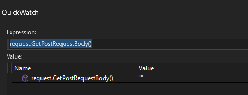

    I double checked the source code the BingMapsRESTToolkit and it is correctly setting Minute as the time unit on the distance matrix request. The response is parsed as-is returned from the service. As a test, you can check the POST body being created for your request using the GetPostRequestBody method. In there you should see timeUnit: 'minute'
    Can you provide a sample of the POST body where you are seeing the issue. Then we can try calling the service directly and seeing if its an issue with the response from the service.
