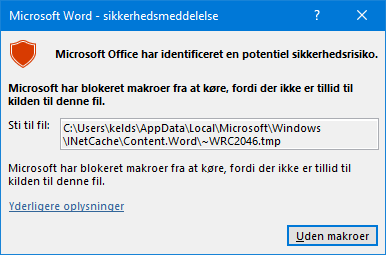

To get rid of that "manually clicking OK" I correct the settings in the "Security center ..." and allow all macros to be enabled eventhough it's not recommended - then run again ... but another message comes up:
billede
Again I have to manually click the button (Without macros) ... but for a strange filename not known to me !
The app works again but it ends up in a completely mess around nor been able to save the NORMAL.DOTM !
How should these stupid checkmark be set in the "Security center... " for me to run my macro ONE TIME only ?

  1. John Korchok 226.2K Reputation points Volunteer Moderator
    2023-06-29T14:46:05.68+00:00
    Microsoft has recently tightened up macro security, so you situation is fairly common now. Try setting the location of the macro-enabled document as a Trusted Location in the Trust Center settings. If the location is on a network drive, you should use the server name, not an IP address in the Trusted Location setting.
