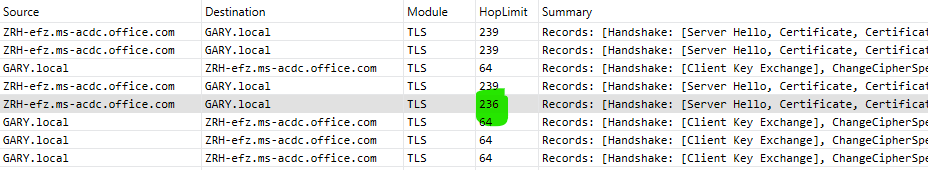

    I would suggest using Event Tracing for Windows to try to understand the behaviour and results of passive probing.
    I tried using a trace session that included the Microsoft-Windows-NCSI provider, the ncsi.dll NCSI TraceLogging providers and a network packet trace provider (such as Microsoft-Windows-PktMon or Microsoft-Windows-NDIS-PacketCapture).
    The resulting trace file included events such as those pictured below:
    One can then try to identify recently (in the last 15 seconds) received packets that led to the HopCount estimate; in my test, I think that the packets were like those pictured below:
    I think that some calculation using the IPv6 HopLimit value of 236 is the source of the "hopCount=20" event in the first image.
    Perform a similar test in your set-up and see whether that throws any light on the problem and whether that suggests a solution.
