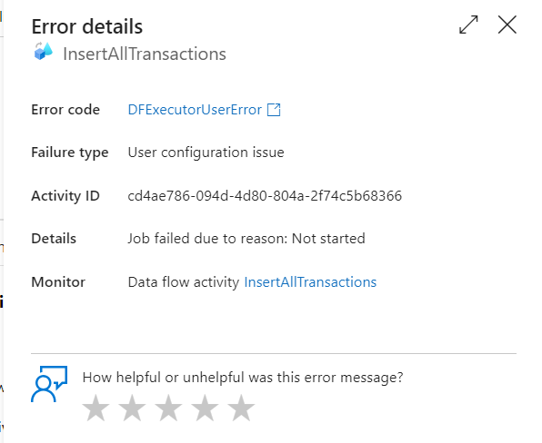

Error in pipeline execution :- Job failed due to reason: Not started
Anshulee Asthana 0 Reputation points
2023-08-09T07:46:28.9466667+00:00

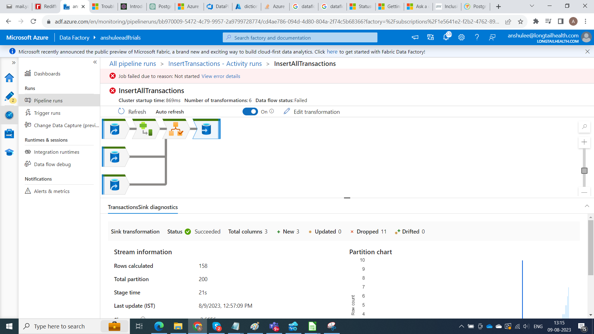

While executing a pipeline i am getting the following final error
All stages seem successful but there are no records in the sink. What is the issue?

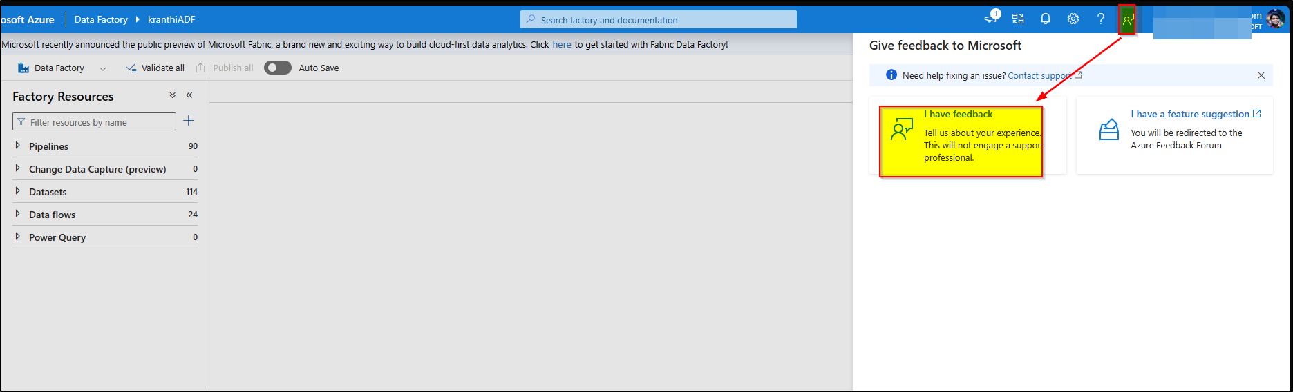

    I agree that the error message could have been better described in the error message. I would highly encourage you to please share feedback directly from ADF Portal as below:

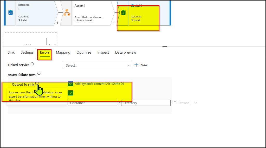

    Since the issue is only with few records and you would like to continue the process on error by skipping errored rows, then you can utilize the Error row handling settings in Mapping data flow sink transformation. Using these settings your data will copied to database and all the bad records can be skipped and logged to storage file for fixing.
    You can refer to this documentaion which has a demonstration video and in detailed information: Mapping data flow sink - Error row handling
    In addition you can also refer to this document for additional information: Handle SQL truncation error rows in Data Factory mapping data flows
