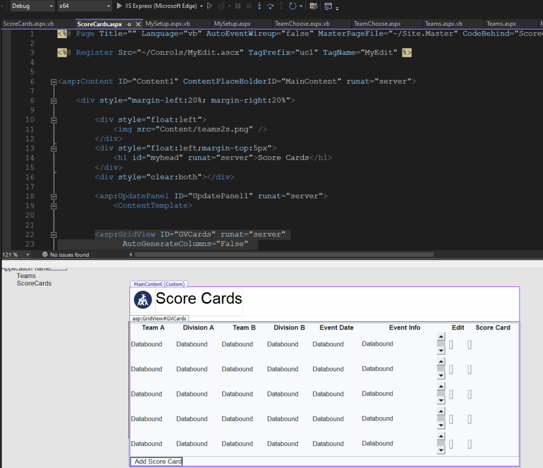

    Well, say we have this button on a web page, and we need to find that code?
    Well, open up the page in design mode, and simple double click on that button.
    It looks/works like this:
    So, say we open the web page ScoreCards from visual studio:
    butnav
    Is that not amazing and simple?
    This perhaps is one of the greatest features of web forms. The ability to open a UI, and click on a button to find that ONE code bit and button out of a 1000's of lines of code in a big application?
    So, we looked at the running web site, and the URL. Then opened up that page in design view. Then a simple double click on the given button, and we are jumped to code behind.

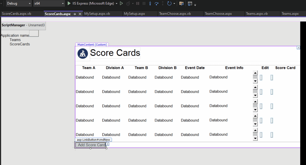

    Of course not all buttons and code will work with a simple double click as above shows. So, in above, we had a row click for the GridView. So, for that, I suggest changing the form design view to split.
    So, now first click on the gridview, and then click on the button. It looks like this:
    gvgetbut
    Once again, for a large application? Well, we are following the GUI, and thus in a way "traversing" the application right down to where we want to go.
    In above, we thus see the OnClick event. So, we can right click, and now go view code.
    Since I highlighted the onclick event, then that's in my paste buffer.
    So, the right click sequence looks like this:
    gvrob
    So, once again, we using "mostly" the GUI to navigate down to ONE bit of code, and this approach works for small, or large applications.

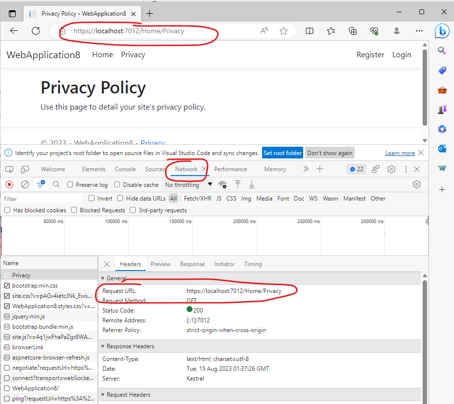

    i want to know from UI or browser of the application that when i am clicking or accessing this particular page from UI so in backend which method or are page it is calling ?
    As AgaveJoe said, you can use the DevTools(F12) Network Tab to check the request URL, the according to the request URL and route template to find which page or method is calling.
    For example, before clicking the Privacy hyperlink, we can open the F12 Developer Tools Network Tab, then after clicking the Privacy link, it will redirect to Privacy page, since this application is an Asp.net Core MVC application, based on the route template, we can know it will access the Home controller and Privacy method.
    Besides, you can also collect a network trace with Fiddler. More detail information, see How to collect a network trace.
