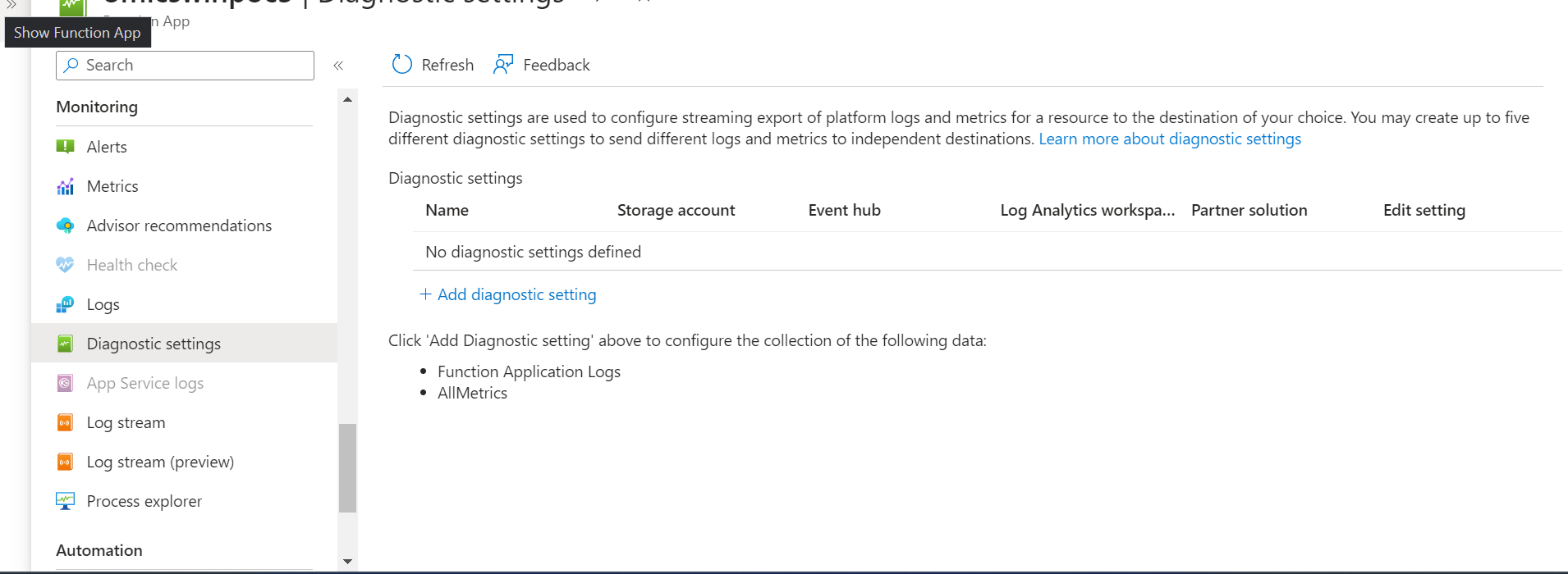

I have created Azure Function Apps, one with NodeJS runtime and another with Python. When I test/run those functions I am unable to see logs in monitor section since last couple of weeks. Can someone help me for understanding or resolving this problem?
(Monitor only shows the message - Results may be delayed for up to 5 minutes.)

    I understand that you are facing an issue with Azure Function Apps, where you are unable to see logs in the monitor section when testing or running functions with NodeJS and Python runtimes. The monitor only shows the message Results may be delayed for up to 5 minutes.
    There are multiple ways you can view the Azure Function logs. Please see the below suggestions, you can follow any of the below suggestions, whichever is feasible to you.
    Using Kudu Console:
    The Function logs are written to the log files. You can access these logs from the Kudu console from Azure FunctionApp portal as shown below:
    Using Logger and also loglevel:**
    Ensure that you have configured the logger as mentioned in this document.
    Also the logLevel is defined in the host.json. So please check within your host.json file which logLevel has been defined.

    Using Visual Studio Code and the Azure Functions Extension
    From your VS Code, using the Azure Functions Extension) you can try to connect to the log stream of your azure function as shown below:
    enter image description here
