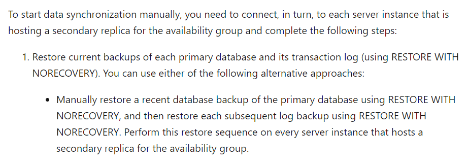

    If the HADR resume is not working, you might have to restore from a backup, including the transaction logs. I understand this could be challenging, especially for larger databases.
