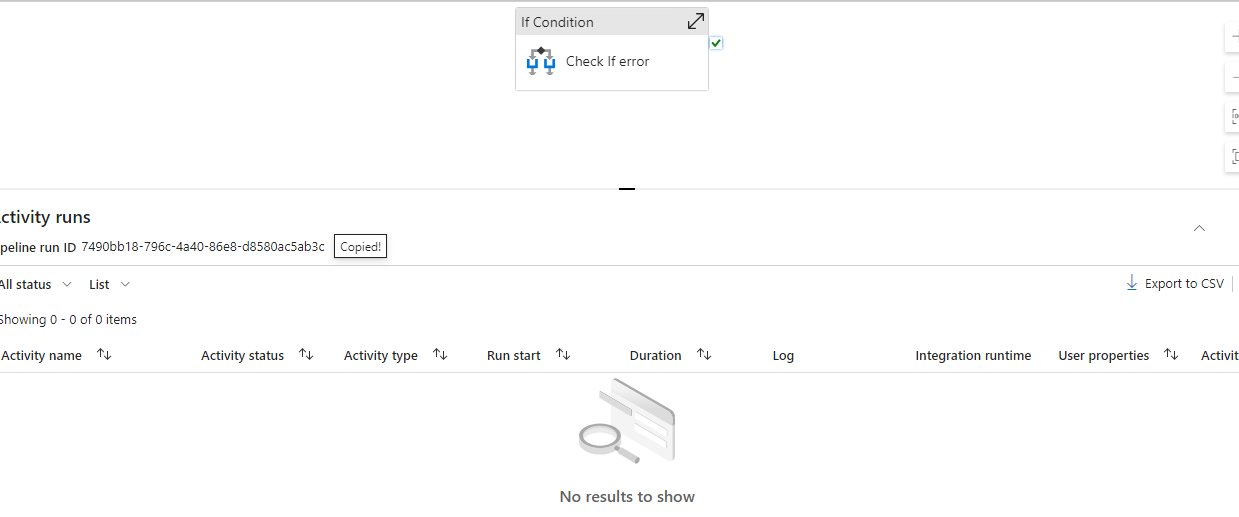

I have one child pipeline which is executed from the parent pipeline. In the parent pipeline I have a for-each loop (sequential) which executes the child pipeline. Everything was working fine till last week. From the last week the call to the child pipeline is failing with internal server error. There are no logs or additional details because the child pipeline is failing. I don't see any activity in the child pipeline. The error is: internal server error.
Error code: InternalServerError
Failure type: System error
Activity ID: a2fe6997-32cd-4a4b-acb5-2a1bfe7a1f1c
Pipeline run Id: 7490bb18-796c-4a40-86e8-d8580ac5ab3c
Details: InternalServerError executing request
Error source: Pipeline XMLToSnowflake
Region: West US 2
With this I am not able to figure out what could be the cause.

    As I understand your query, you are witnessing error in the child pipeline and it says "InternalServerError executing request" . Please let me know if that is not the correct understanding.
    Kindly try executing the child pipeline independently to see if it runs successfully.
    Additionally , please try checking the dataset and linked service used underneath the child pipeline is connected without any issue or not.
    I suspect there is some issue with the source data . Kindly let us know how it goes.
