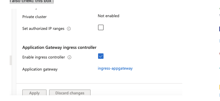

i also chekc this box :
Screenshot 2023-08-25 at 15.27.39
Now, if I access the address of the nginx in services (External Ip), i get 404 from nginx. Also,if i access ip/v1 , get 404 again.

  1. AirGordon 7,145 Reputation points
    2023-08-26T05:24:28.7333333+00:00
    I think you have a misconfiguration. Your screengrab shows that your using a Azure Application Gateway Ingress Controller. However your ingress manifest is targeting nginx.
    Try deploying an application with a known good configuration for Azure Application Gateway Ingress. Once you see it working, modify for your app.
    Here's my go-to manifest for AGIC: https://github.com/Gordonby/Snippets/blob/master/AKS/Agic-simple.yml
