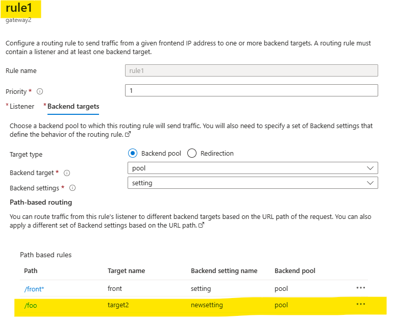

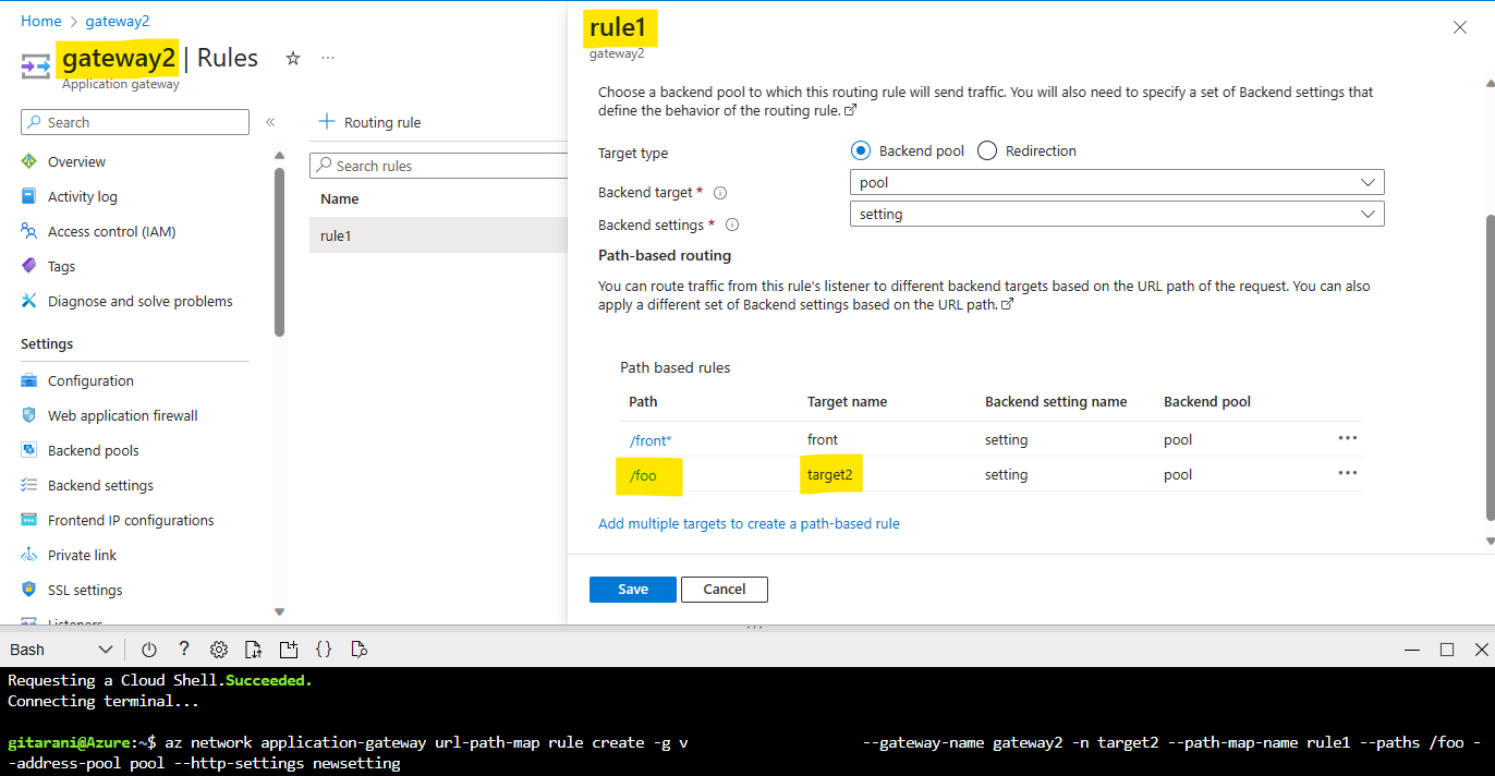

    I tried this in my lab, and it works. You can see the screenshots below for reference:
    After the command completed successfully, the httpsettings for the targetname "target2" was updated as below:
