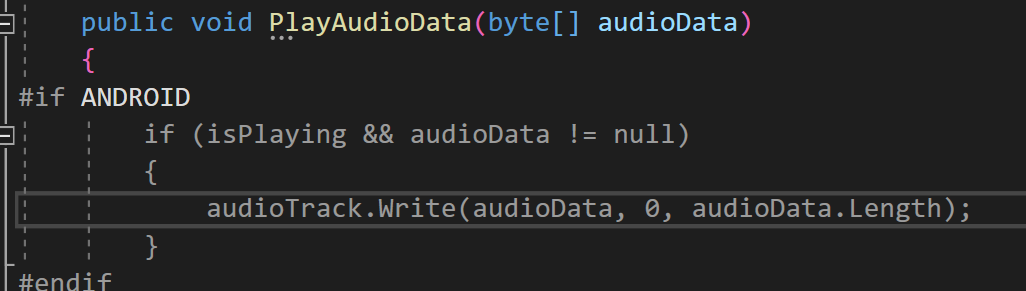

I created an AudioTrack object named audioTrack, and use the audioTrack.Play(), Then in an Event I use the audioTrack.Write() method, and it stuck the MainThread,
I have try to use the async, but it doesn't help.
I also try to use Task.Run() to created new task,but it create so much task threads and cause the program broken.
What should I do?

    You can add fourth attribute WriteMode.NonBlocking in the Writemethod. By the way, when you execute the write method, you can do it inHandlerThread.
    As Note: please don't make a screenshot about your code, you can copy your code here directly.
