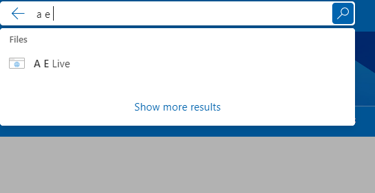

  1. Laura Hutchinson 20 Reputation points
    2023-09-08T08:28:44.56+00:00
    thanks Emily - that all makes sense. The biggest issue is on the site search when the suggestions pop-up I want to be able to configure the layout of how the suggestions appear.
    the image above shows me searching for A E and correctly getting the search result back that I want - its a link from a doc library to an external URL.

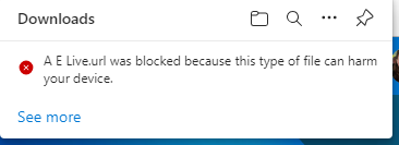

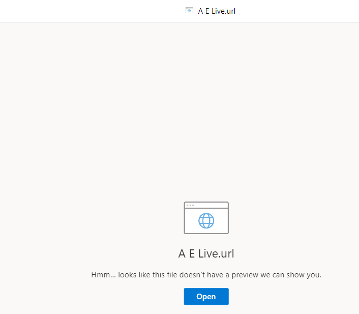

    When I click on the icon or the wording the behaviour I want is to take the user to that external URL. However, it either shows this User's image
    or this User's image
    Is there anyway to amend the layout of the search result to take the user directly to the URL without anymore clicks or extra pages popping up?

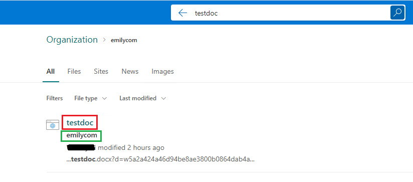

  2. Emily Du-MSFT 51,971 Reputation points Microsoft External Staff
    2023-09-08T06:25:44.0766667+00:00
    Could you provide some screenshots of search results for further troubleshooting?
    Here are my test results.
    1.In the document library, add a URL item (the item points a file stored in the SharePoint).
    2.Search in the document library.User's image
    3.Search in the site collection. When I click testdoc, it redirects me to the URL, open the file in the browser. When I click emilycom, it redirects me to the document library stores the URL item.1
