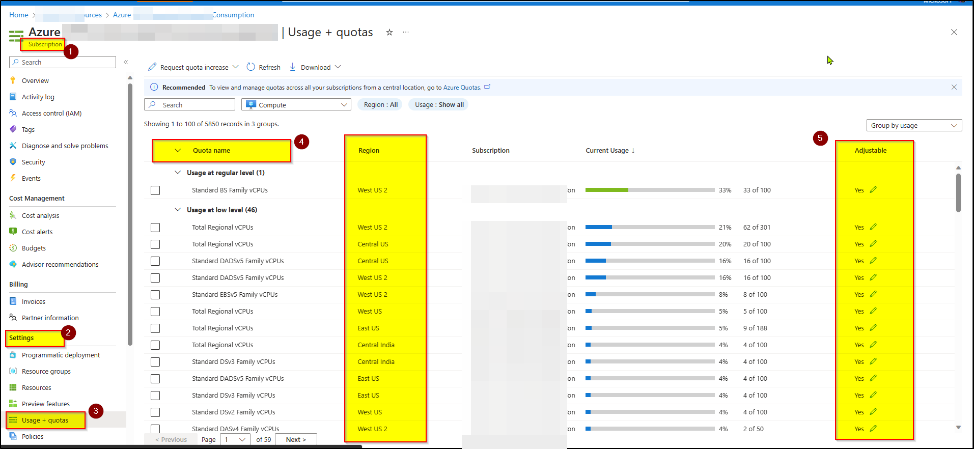

    As per the error message, the issue occurred due to vCPU usage going over the Azure subscription quota limit as pointed out in the message above. You can increase the limits by going to your Azure Subscription > Usage + Quotas.
    How to check Usage + Quotas for your subscription?

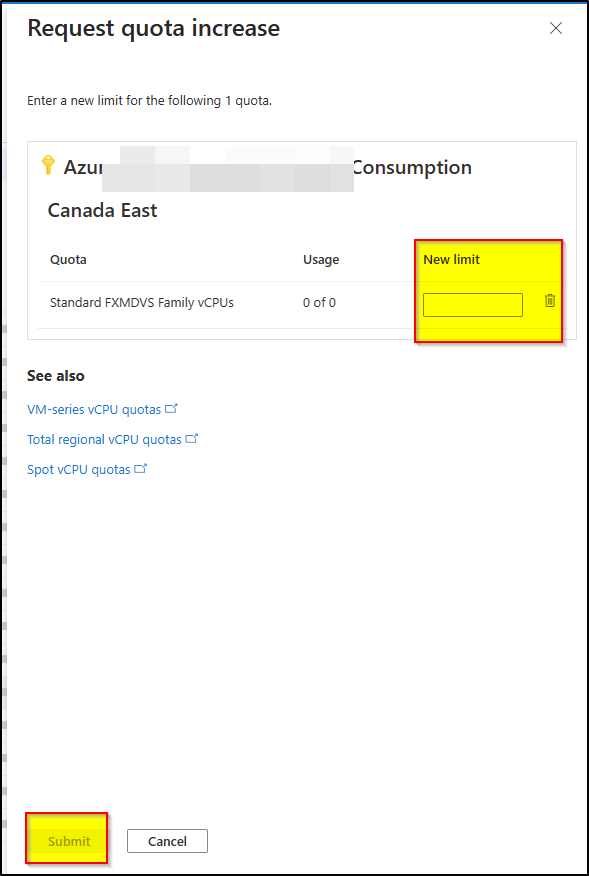

    Select your subscription => Under Settings => Usage + quotas => Use filter to select "Standard" & "<Your region>" => Check usage of Total Regional vCPUs => If the usage is full, you need to click on Request Increase to increase the limit of cores in the region.
