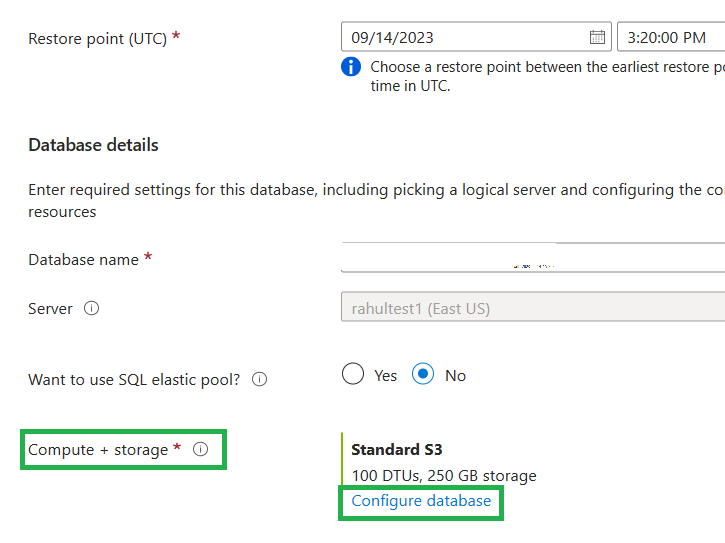

  2. RahulRandive 10,486 Reputation points Volunteer Moderator
    2023-09-14T15:27:37.0866667+00:00
    Hi @Marco Martínez
    When you mention that you are facing difficulties in quickly restoring databases in SQL Azure, if you are referring to the portal's point-in-time restore and it's taking time, it depends on the size of the data you are restoring. However, to allocate more compute resources for the restore process, you can scale up the compute and storage of the restore database until the database is fully restored and then scale it down or choose pricing tier based on your need.
    Let us know if you have any questions or need additional information.
    Thank you!
