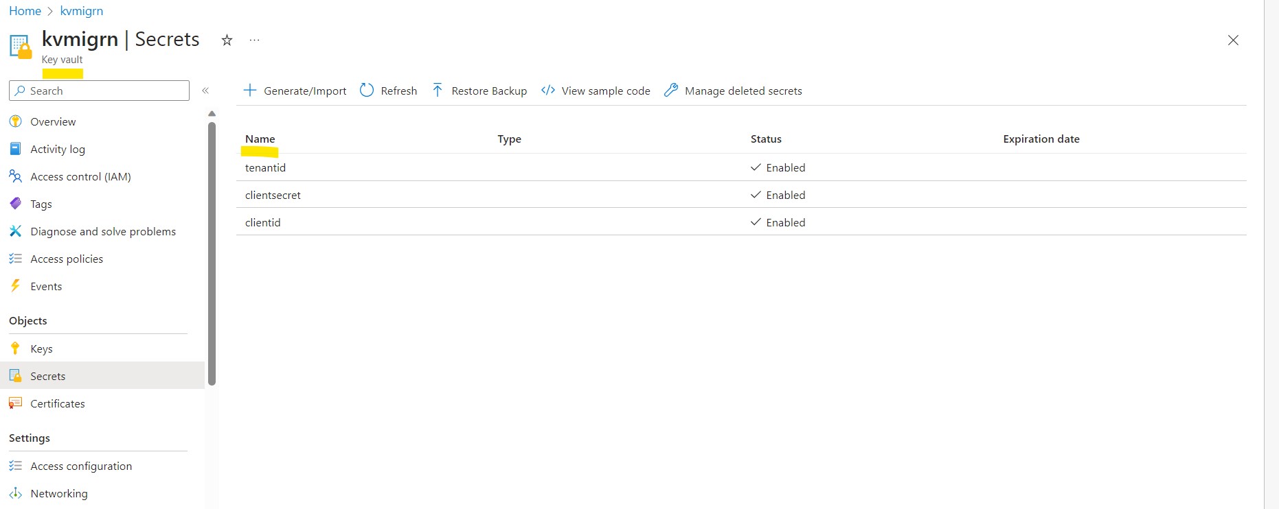

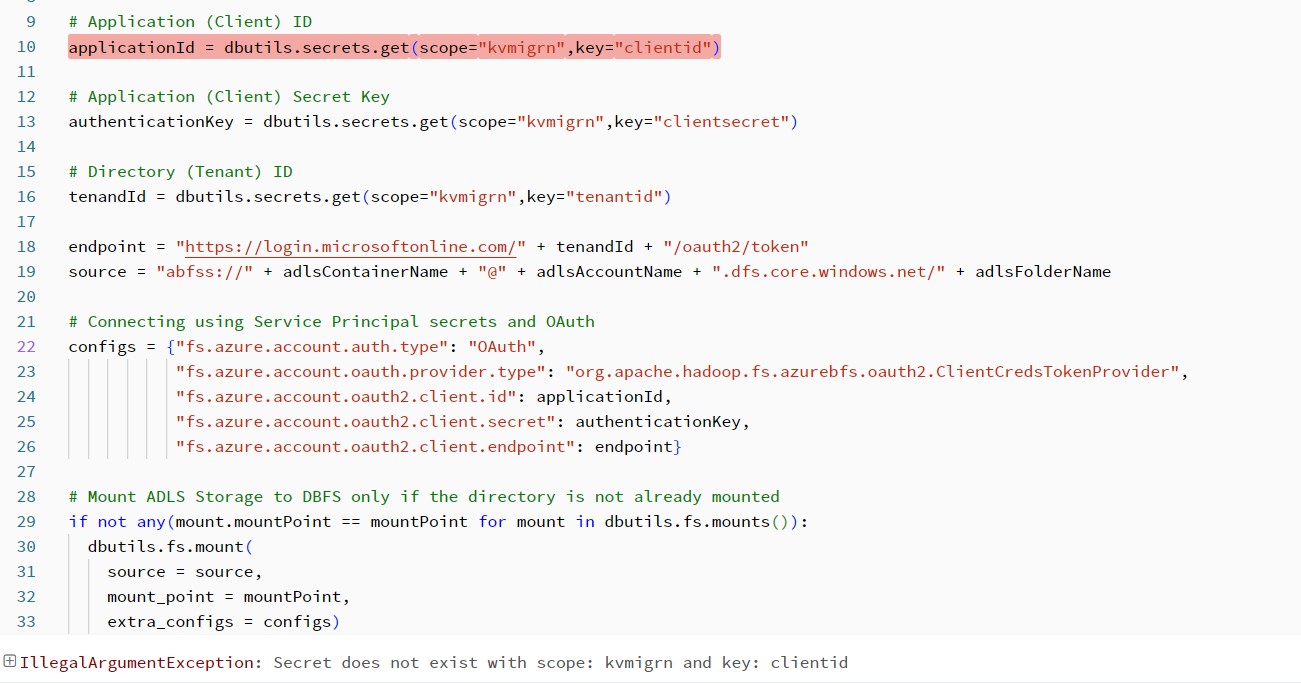

I am constantly getting the below error:"Secret does not exist with scope: kvmigrn and key: clientid". Tried creating an app two times from scratch. I already have a vault like this and a key. Attaching screenshot

    The error is clear there is a missing secret in the specified Databricks secret scope.
    Ensure that the secret scope kvmigrn has been correctly created in Databricks. If you are using Azure Key Vault-backed secret scopes, you need to ensure that the Databricks workspace has permission to list and read secrets from the Key Vault.
    Double-check that the secrets with the keys clientid, clientsecret, and tenantid exist in the kvmigrn scope. Typos and casing can sometimes be a cause of these types of issues.
    Check this link to have an idea : https://community.databricks.com/t5/data-engineering/error-while-mounting-to-adls-gen2-error-secret-does-not-exist/td-p/28915

    Navigate to your Azure Key Vault in the Azure Portal. Check to see if the secret with the key clientid is indeed present in the vault.
    Each secret in AKV can have multiple versions. Ensure you're referencing the right version, or you're set to retrieve the latest version.
    Ensure that the secret hasn’t expired or hasn’t been disabled in the Key Vault.
