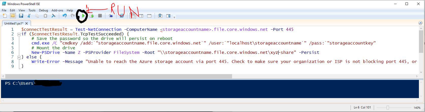

My router failed and I have now rebuilt a new one, but one of the side effects was that the Drives I had created were now corrupted. I removed them using "net use /del", but I am now getting this error when trying to paste in the script from Azure portal. I have not changed any other setting and there is not "" at the end of the folder. I have even double checked to see if the Drives have really been removed, and they have. Any ideas welcome.
