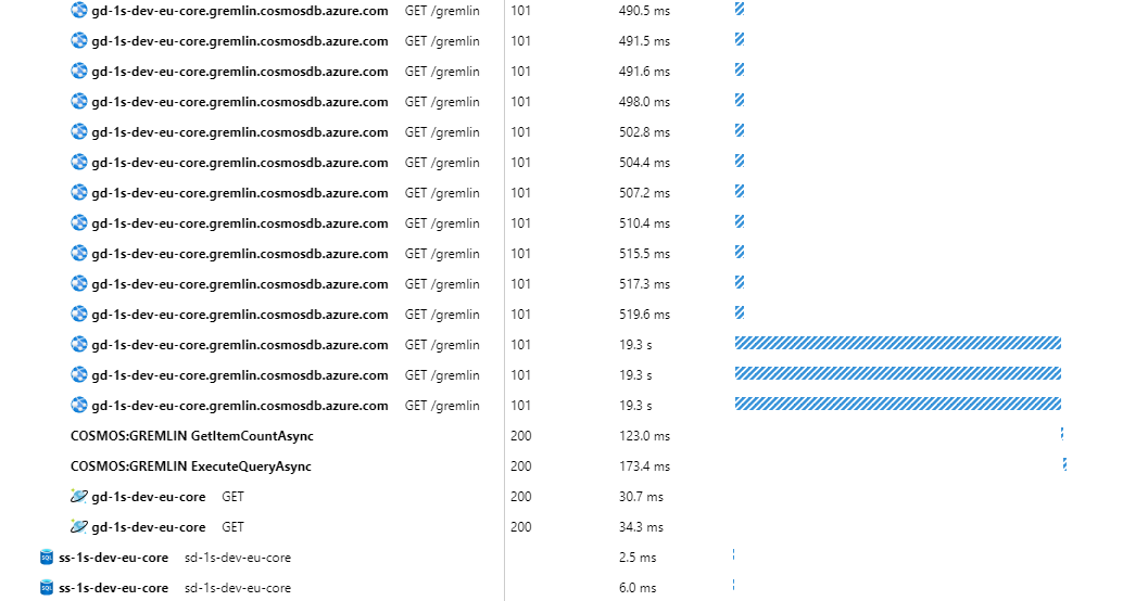

When checking App Insights to see what is going on behind the scenes, I noticed a number of long running requests/redirects which seem to be causing the issues:
When it's working correctly those 101 responses return in < 100ms and the query executes correctly. However, fairly regularly they can take > 30 secs to run and the query times out.
In terms of the database, there is < 1000 records in it. Running the query directly on the DB returns in < 1 sec. I've disabled any other processes that interact with the DB, so it doesn't seem to be a rate-limit issue.

    Managed to resolve this - somewhere else in the project the WebSockets.KeepAliveInterval and ConnectionPoolSettings had been set to a non-default value which was causing this behaviour. Removing that stopped the long running 101 requests.

    Somewhere in the project the WebSockets.KeepAliveInterval and ConnectionPoolSettings had been set to a non-default value which was causing this behaviour.
