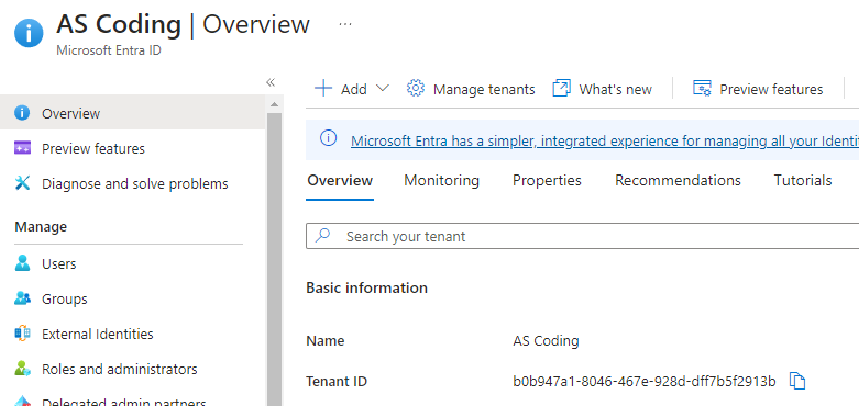

    2023-10-16T22:07:02.6866667+00:00
    Hi @asosinski
    Yes, you will be using the B2C tenant since its Tenant ID is the one present in the login URL, this is a complete separate tenant from the Entra ID one.
    To customize the claims on an EntraID tenant is basically the same process as with the B2C one, but the main change is that there will be no user flow policies in place for each sign in as this type of tenant is more focused for consumer sign in. the document below has more information about customizing JWT, ID and Access tokens: https://learn.microsoft.com/en-us/azure/active-directory/develop/jwt-claims-customization
    If it does not work either, I'd suggest you to open a support ticket with our B2C team. If you do not have that option available to you, let me know as we can work on another way for you to open it.
