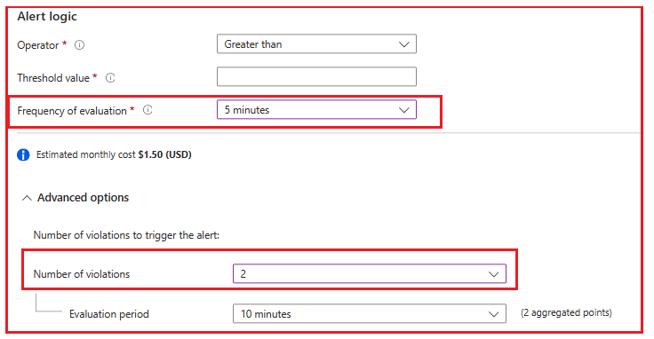

    Another similar outcome could also be achieved if you are forwarding the metrics to Log Analytics workspace using the "Log based alert rule". There, an option is available to trigger after only X violations of alerting condition have happened. For example, consider the following:
    In this case, the query is run every 5 minutes, but an alert is raised only if there are 2 violations, i.e., the alert will be generated after 10 minutes only.
    You may choose to use either of the options to achieve the end goal.
