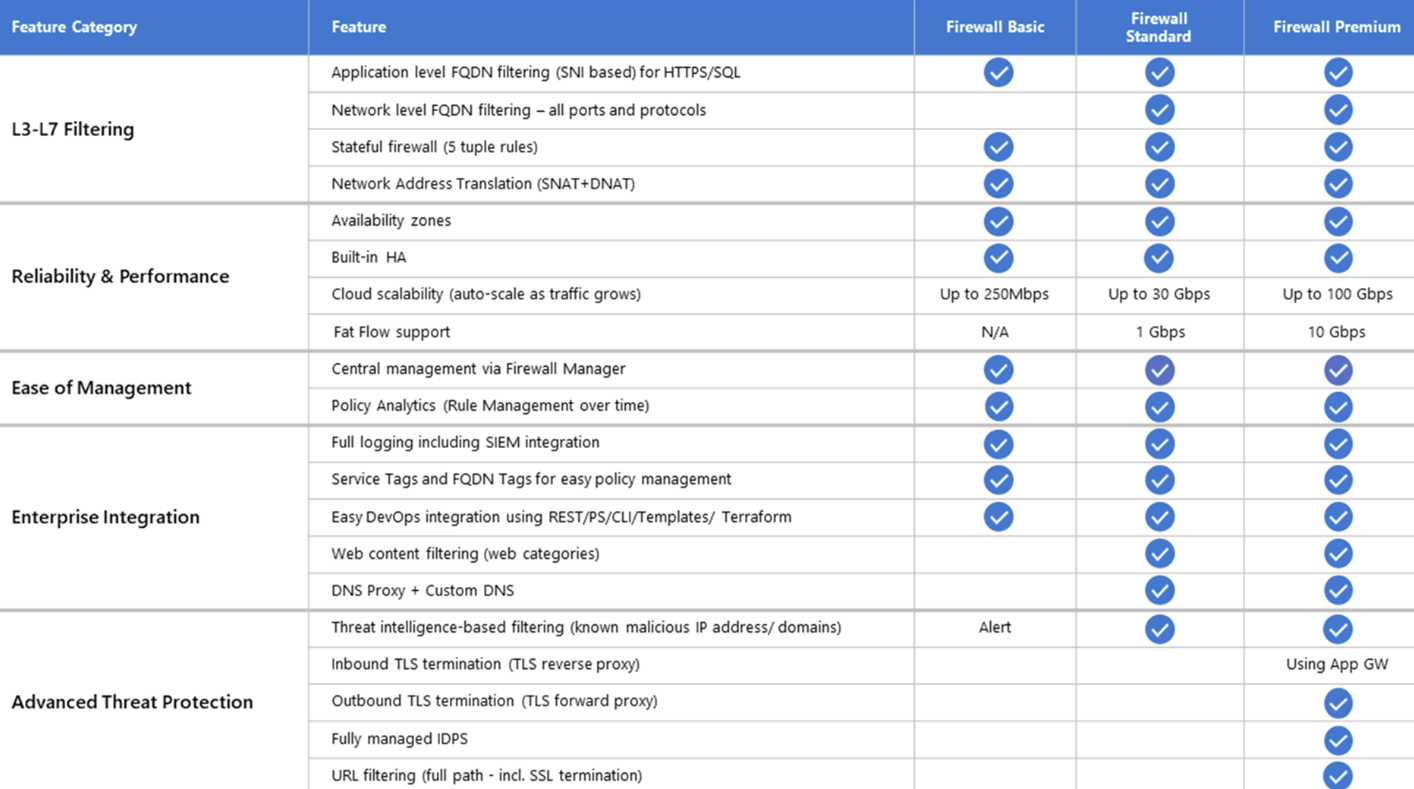

    • Here's a list of all supported features with various SKUs:
