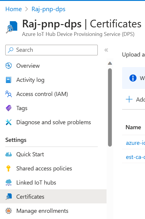

    Also we dont see TLS Certificate tab in Azure Portal --> IOT hub --> settings --> Certificates why?
    If you referring to the root certificates that are recognized by the IoT Hub, you would find them under the certificates tab under your Device Provisioning Service. Please refer the below image for reference.
