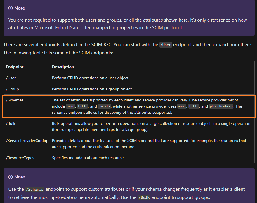

Is supporting the /schemas endpoint mandatory for the scim validator as mentioned here? We don't but it's not mandatory as far as I can tell from the RFC.

    When it comes to the /Schemas endpoint I don't believe this is mandatory, but it does look like it's recommended since the /schemas endpoint allows for discovery of the attributes supported.
