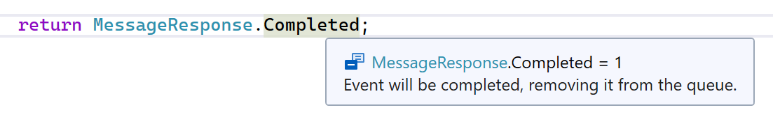

I checked the code for more details on the response.
Completed:
