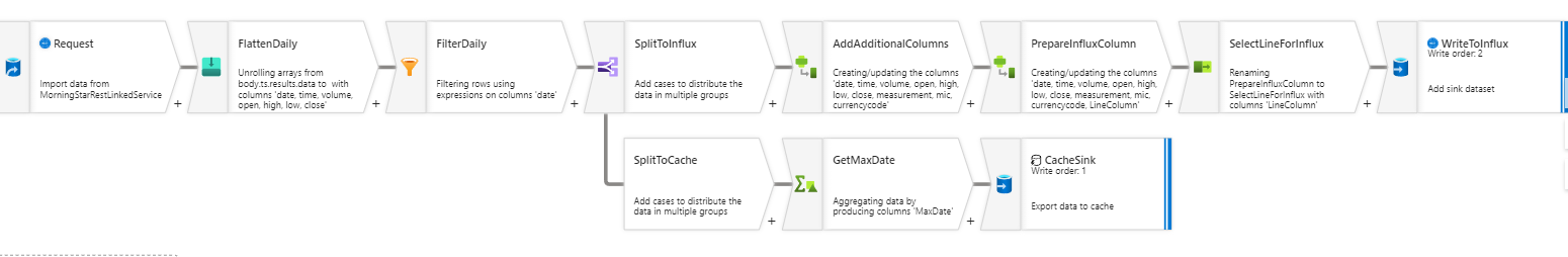

I am making a HTTP Request to a webservice that returns a csv (>1MB csv) which I am converting it (row by row) to LINE protocol for an Influx DB using a Dataflow.
The transformation works ok(~1min) using the default integration runtime.
DF

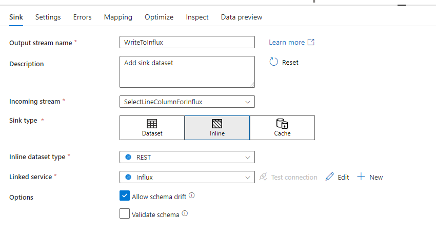

The problem comes when I try to "POST" that information to the Influx Db using a REST linked service (with None as format).
Rest Linked Service
Sink 1
Sink 2
It is working, but really really slow (about 30 min for 60k rows) and its not the Influx endpoint's problem because when I try to "POST" already transformed rows (using Postman) to the same endpoint it takes a few seconds for ~500k rows.
I think ADF tries to "POST" them in small batches or something because I can query the sink (Influx Db) and I see the way it "grows" up (really slow).
Can a batch size setting be increased for a "None" format?
