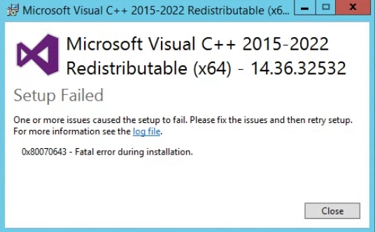

I have a single 2012 R2 server this is happening with, and I believe it's also preventing the upgrade of the operating system because when I attempted the OS upgrade it failed with a message about a problem due to an installed component. This is the only system in our entire environment that I've seen this issue. Initially I wouldn't have known to look for this specifically, but an attempt to upgrade VMware tools led to the discovery that trying to install/update/repair C++ Redistributable on the system is failing every time.
As a sidenote - the server does have a bunch of older C++ Redistributable versions installed, but I'm afraid to just attempt to rip it all out since I'm worried the software installed on the server might require one or more of those. I've attempted a few things from the scarce posts I found online with a similar issue - which sadly looks in most cases like it was never resolved for others.

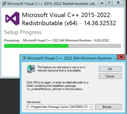

Manually running the latest C++ Redistributable installer ends up erroring as seen here:
2023-11-14 09_27_39
2023-11-14 09_28_23
2023-11-14 09_29_45
Here are the contents of the generated log file:

3 answers
    2023-11-15T15:37:16.2433333+00:00
    In-place upgrades can be problematic for any number of reasons. The operating system does not use or require the C++ runtime so you could try removing it but time may be better spent standing up a new one, patch fully, migrate roles over and move on.
    --please don't forget to close up the thread here by marking answer if the reply is helpful--
    2023-11-15T15:49:43.4433333+00:00
    OS appears to be corrupt. You could try this one.
    https://support.microsoft.com/en-us/topic/fix-problems-that-block-programs-from-being-installed-or-removed-cca7d1b6-65a9-3d98-426b-e9f927e1eb4d
  3. Tianyu Sun-MSFT 34,806 Reputation points Microsoft External Staff
    2023-11-21T09:15:57.4733333+00:00
    Hi @A_G_23 ,
    If you didn’t uninstall the Minimum Runtime(Microsoft Visual C++ 2015-2022 Redistributable (x64) Minimum Runtime -14.36.32532/Microsoft Visual C++ 2022 X64 Minimum Runtime -14.36.32532) and Additional Runtime(Microsoft Visual C++ 2015-2022 Redistributable (x64) Additional Runtime -14.36.32532/Microsoft Visual C++ 2022 X64 Additional Runtime – 14.36.32532) by using troubleshooter tool, then please also try to uninstall them by using the troubleshooter tool and check again.
    Sincerely,
    Tianyu
