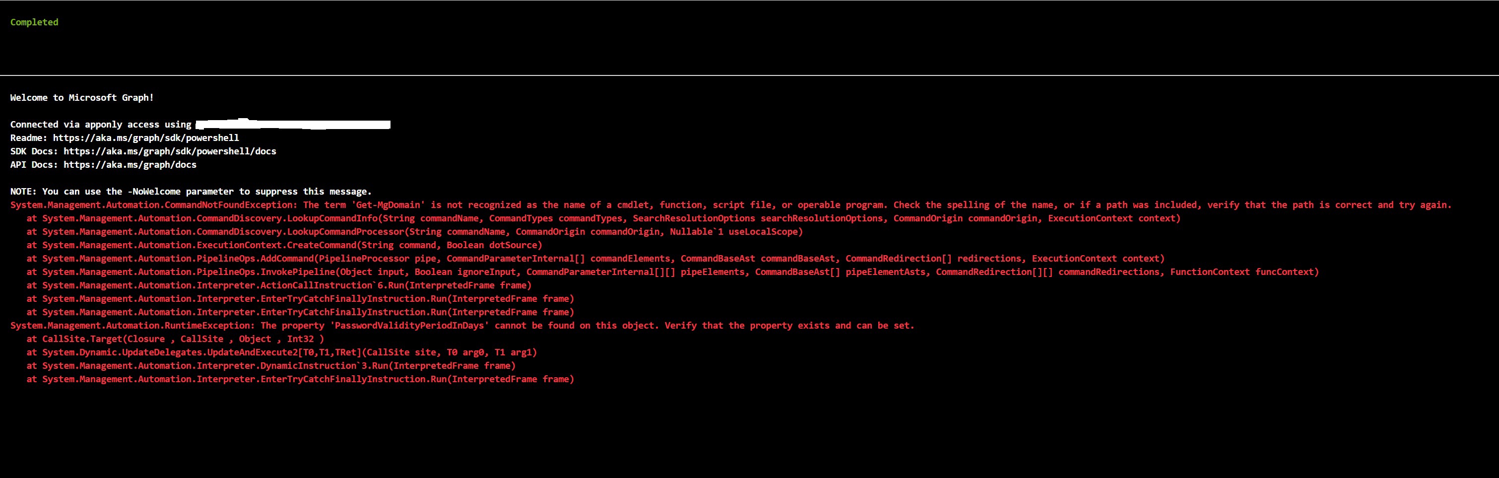

I´m trying to run this powershell script in Azure automation but it gives this error. Does anybody have a tip on how to solve this?

    Based on the error as available in the attached email, Get-MgDomain is not being recognized as an available cmdlet. Based on the doc here, it is available in Microsoft.Graph.Identity.DirectoryManagement module.
    I would suggest importing the following modules to Azure Automation from gallery to ensure that the module is available for the cmdlet to run.
    • Microsoft.Graph.Identity.DirectoryManagement
    • Microsoft.Graph.Authentication
