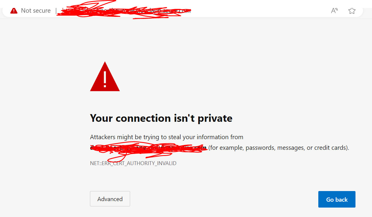

When I am calling rest api from the custom script I get following error
"Message": "The remote certificate is invalid according to the validation procedure.",
"Message": "The underlying connection was closed: Could not establish trust relationship for the SSL/TLS secure channel."
