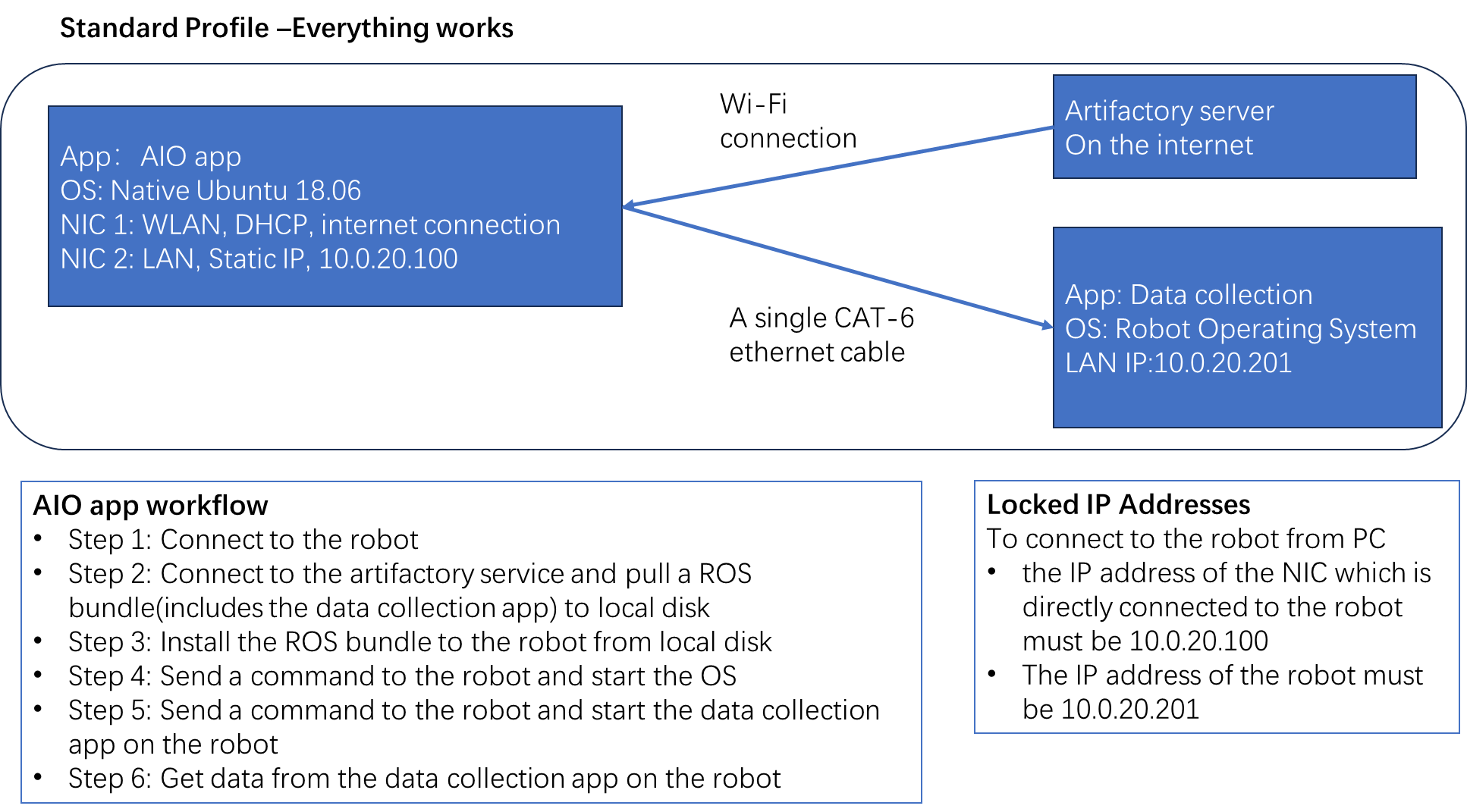

Basic Environment
  1. Windows 11, using WSL2(ubuntu 18.04 x64) to work with a ROS application devopment.
  2. And there is a native ubuntu 18.04 on my pc.
  3. The AIO app needs to connect to 2 things, the artifactory service(on the internet) and the robot by a CAT-6 cable directly.
  4. To connect to the robot from Ubuntu,
    1. the IP address of the NIC on PC which is directly connected to the robot must be 10.0.20.100
      1. the IP address of the robot must be 10.0.20.201
  5. Unable to modify the AIO app
  6. So there are 2 NICs in my computer, the WLAN NIC is connected to the internet while the LAN NIC is connected to the robot.
AIO app workflow
Step 1: Connect to the robot
Step 2: Connect to the artifactory service and pull a ROS bundle(includes the data collection app) to local disk
Step 3: Install the ROS bundle to the robot from local disk
Step 4: Send a command to the robot and start the ROS
Step 5: Send a command to the robot and start the data collection app on the robot
Step 6: Get data from the data collection app on the robot
Problem
the AIO app works well on native ubuntu, but it can't get any data on WSL Ubuntu.
I tried many network configations and the status are in the 2 tables below.
If we can use 2 NICs in bridged mode on WSL, there probably be a way to work.
However, I can't find any tutorial how to enbale 2 NICs in .wslconfig file.
So how to get it work? Thanks!
