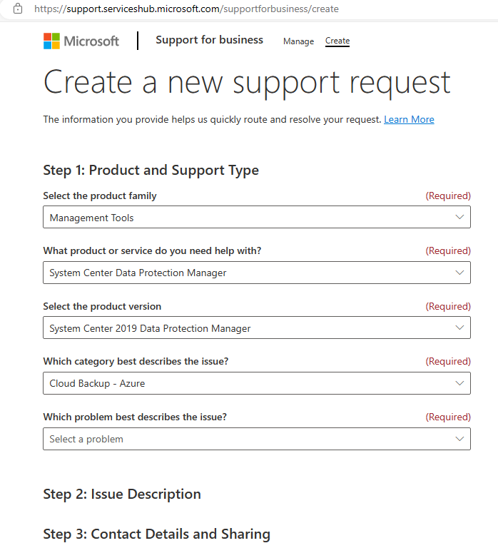

    If none of these solutions work, you may need to contact the CSS support team for further assistance.
