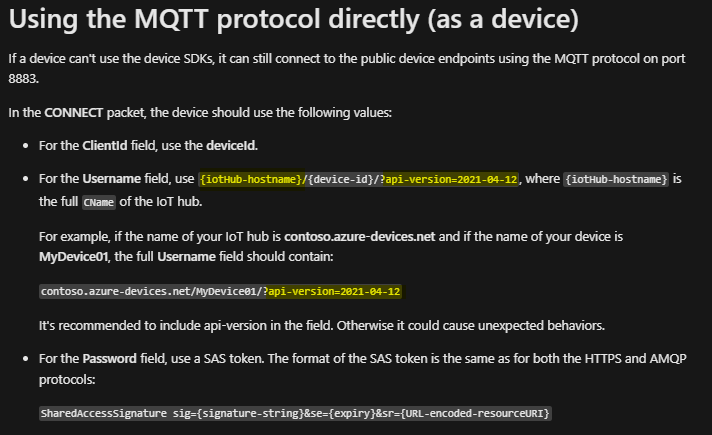

    Vignesh Greetings & Welcome to Microsoft Q&A forum!
    How to connect the simcom767G to azure iot hub using MQTT protocol
    What is the issue you are facing? Did you check the documentation Communicate with an IoT hub using the MQTT protocol?
    how i get the username of iot hub and sas token and iot hub url and iot hub api version
    Also, make sure that your device is provisioned in IoT Hub and that you have the necessary permissions to connect to IoT Hub using MQTT.
    Hope this helps. Do let me know if you have any other queries.
