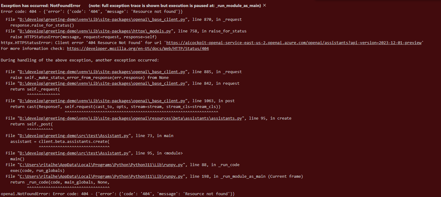

Hey folks,
I'm currently working with the Azure OpenAI service, and I've successfully deployed the gpt-4-1106-preview model. However, when attempting to create an Assistant, I ran into a stumbling block - a pesky 404 error (httpx.HTTPStatusError: Client error '404 Resource Not Found' for url 'https://aicockpit-openai-service-east-us-2.openai.azure.com/openai/assistants?api-version=2023-12-01-preview').
I'm curious to know if the Azure OpenAI service supports the Assistant API. If it does, could someone kindly guide me through the process of creating an Assistant with the gpt-4-1106-preview model?
Appreciate any insights or help you can provide!
client = openai.AzureOpenAI(
        azure_endpoint= "https://aicockpit-openai-service-east-us-2.openai.azure.com",
        api_key="xxxxxxxxxxxxx",
        api_version="2023-12-01-preview",
        max_retries=3
assistant = client.beta.assistants.create(
        name="Math Tutor",
        instructions="You are a personal math tutor. Write and run code to answer math questions.",
        tools=[{"type": "code_interpreter"}],
        model="gpt-4-1106-preview"

    Thanks for the question, Assistants API will be available in Azure Open AI and will be supported in the near future. It's in roadmap to support new release of GPT-4 and Assistants API will be available in Azure Open AI.

    Hi, is this supported yet? It looks like it should be here:
    https://github.com/Azure-Samples/azureai-samples/tree/main/scenarios/Assistants/assistants-api-in-a-box
    but I still get the 404 resource not found with the above?
    If it is supported what api version should I be using please? My code works fine with the OPENAI client just not the Azure OPENAI client (I am passing in api key, and endpoint and version)
    I have tried versions :
    2023-12-01-preview Swagger spec
    2024-02-15-previewSwagger spec
    model = "gpt-4"
    thanks.
