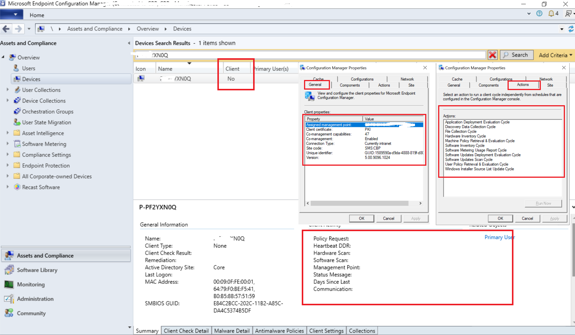

We often see client devices listed in MECM (Configuration Manager) being reported as having No client software installed and not having communicated with MECM at any point recently (see attached file), even when they have been online connected to the network for several days, and even when the user is shown via MECM aas being logged on at the time.
On such client devices we have confirmed:
  1. No network connectivity isssues from the client to the Managament Point via PING, NSLOOKUP and Tracert commands
  2. The client has Configuration Management software installed and it looks healthy - shows MP details, shows it has a PKI certificate and shows SMS Site Code and all actions are available (see inset into the attached file here)
  3. On examining the LocationServices log file from C:\Windows\CCM\Logs has listed the address of the Management Points we use
  4. Verified the SMS service and WMI serviuce are running on the client
  5. Through winmgmt /verifyrepoistory also has a working WMI
Thus why does only an un-install of the Configuration Manager Client on the device (ccmsetup.exe /un-install) and then a re-install (ccmsetup.exe /UsePKICert /NoCRLCheck SMSMP=https://Management_Point_URL FSP=Management_Point_URL DNSSUFFIX=Domain_Name SMSCACHESIZE=20480) resolve the issue
What is it that the client is missing\has wrong that prevents it from having communicated with the Management Point when all appears well on the client and the client has been online consistently ? What else can be checked on the client device ? Where\how would we check for any certificates issues if that is needed ? In regard to the last point, we have also vereified the Management Point is fine using tests as outlined in the article https://www.recastsoftware.com/resources/how-to-test-your-mp-to-confirm-if-it-is-healthy/

    Thanks. Where would we check the client certificate validity i.e. where within certificate Manager - computer Certificate in Personal or Trusted Publishers section etc ?. Also if the following on a client reports correctly doe sthat mean the client certificate is OK anyway ? https://www.recastsoftware.com/resources/how-to-test-your-mp-to-confirm-if-it-is-healthy/
    Clients with this issue of not apparently cmmunicating to the MECM Management Point, are listed as registered with Azure\Entra ID.
    Thus still struggling to find a reason as to why teh clients appear not to be talking to the Management Point, where vall seems OK on them.
