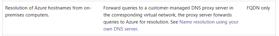

    For on-premises workloads to resolve the Azure hostname or FQDN of a private endpoint, you must use a DNS forwarder in Azure, which in turn is responsible for resolving all the DNS queries via a server-level forwarder to the Azure-provided DNS 168.63.129.16. A DNS forwarder is a Virtual Machine running on the Virtual Network linked to the Private DNS Zone that can proxy DNS queries coming from other Virtual Networks or from on-premises.
    If you check the table in Name resolution for resources in Azure virtual networks article, you can find the below:
    Refer: https://learn.microsoft.com/en-us/azure/virtual-network/virtual-networks-name-resolution-for-vms-and-role-instances?tabs=redhat
