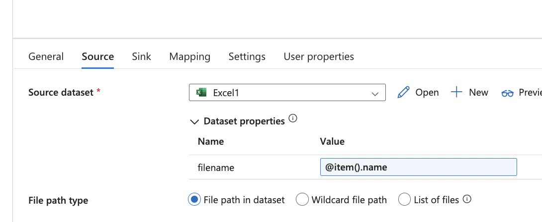

    • Copy activity 1 source tab: Screenshot 2023-12-04 at 7.50.21 PM
    Source dataset:
    Screenshot 2023-12-04 at 7.51.19 PM

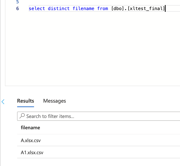

    Table data after loading:
    Screenshot 2023-12-04 at 7.59.32 PM
    As you note from here, we can get rid of the .csv from your table column easily! Either by an update or you can also try to avoid the concat() that i have used in the copy activity 1 sink and copy activity 2 source.
