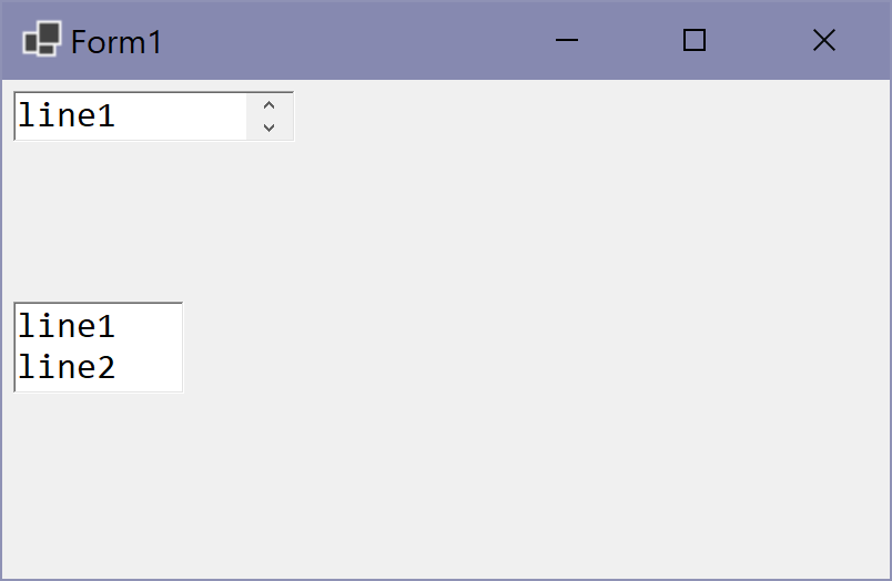

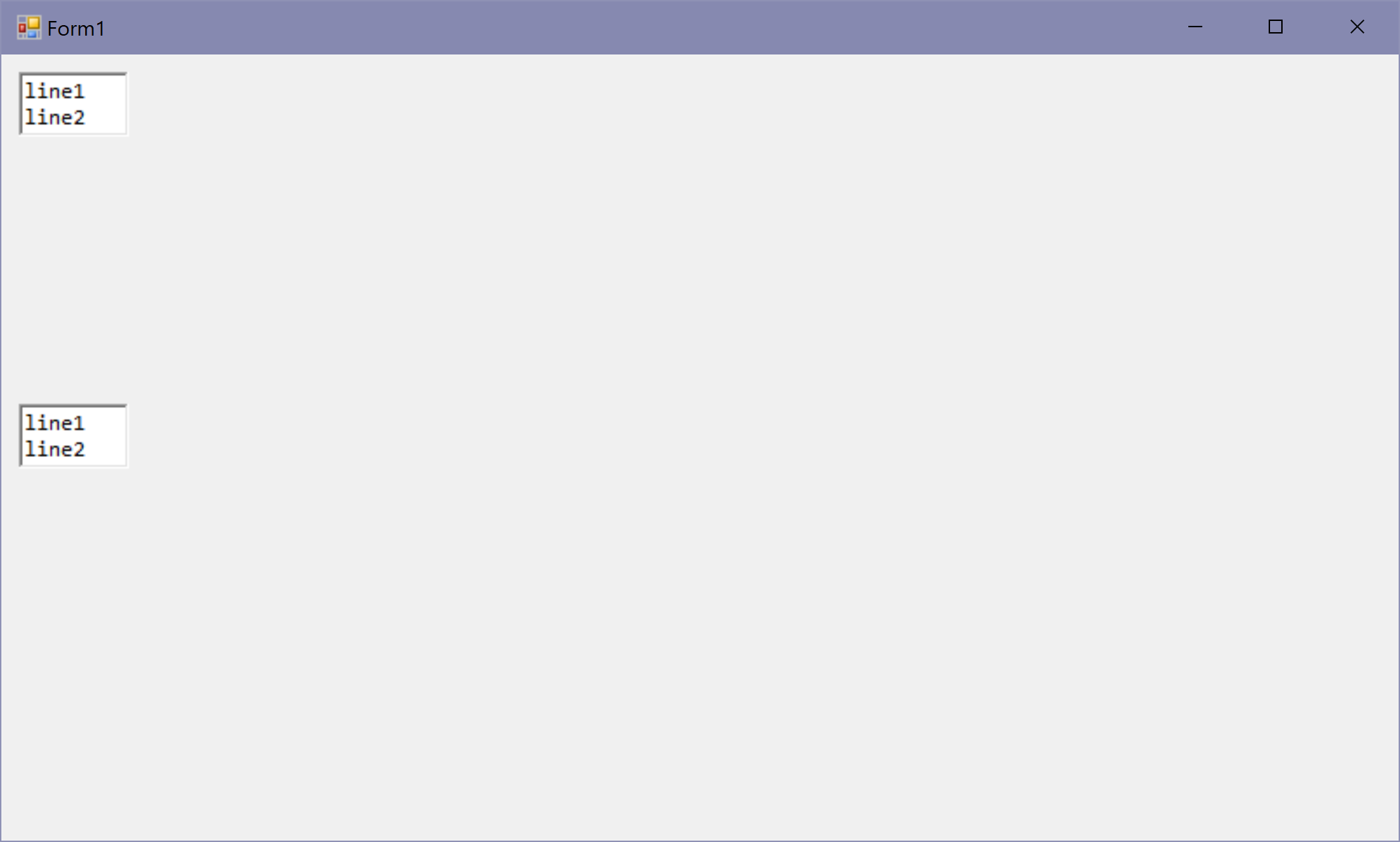

When built and run under .net framework 4.8 this produces:
net48_result
And under .net 8 this produces:
net8_result
Why did the behaviour change, and is there a way to prevent the difference (without changing the RTF to use \par)?
