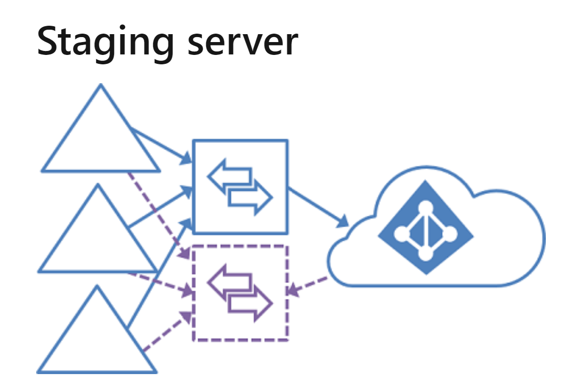

Hello,
We've one root domain with azure ad connect to sync users to MS tenant, and other child domain with no ad sync.
we need to add staging server in the root domain for high availability, and one active server in the root domain, and all three servers will connect using the same global admin account.
does the above scenario will works and supported? or there is another scenario whats the best practice.
Thanks,

    As per Single forest, multiple sync servers to one Microsoft Entra tenant, having multiple Microsoft Entra Connect Sync servers connected to the same Microsoft Entra tenant is not supported, except for a staging server. It's unsupported even if these servers are configured to synchronize with a mutually exclusive set of objects. You might have considered this topology if you can't reach all domains in the forest from a single server, or if you want to distribute load across several servers. (No errors occur when a new Azure AD Sync Server is configured for a new Microsoft Entra forest and a new verified child domain.)
    Microsoft Entra Connect supports installing a second server in staging mode. A server in this mode reads data from all connected directories but does not write anything to connected directories. It uses the normal synchronization cycle and therefore has an updated copy of the identity data.
    In a disaster where the primary server fails, you can fail over to the staging server. You do this in the Microsoft Entra Connect wizard. This second server can be located in a different datacenter because no infrastructure is shared with the primary server. You must manually copy any configuration change made on the primary server to the second server.

  1. Thameur-BOURBITA 36,236 Reputation points
    2023-12-05T09:42:03.3+00:00
    Hi @Ahmed Essam
    Single forest with multiple active server Entra connect is ot supported:
    Unsupported, filtered topology for a single forest
    You should install one active server and a second staging server to ensure the high availability.
    To get more details supported and recommended design of Entra connect please read the following article:
    Topologies for Microsoft Entra Connect
