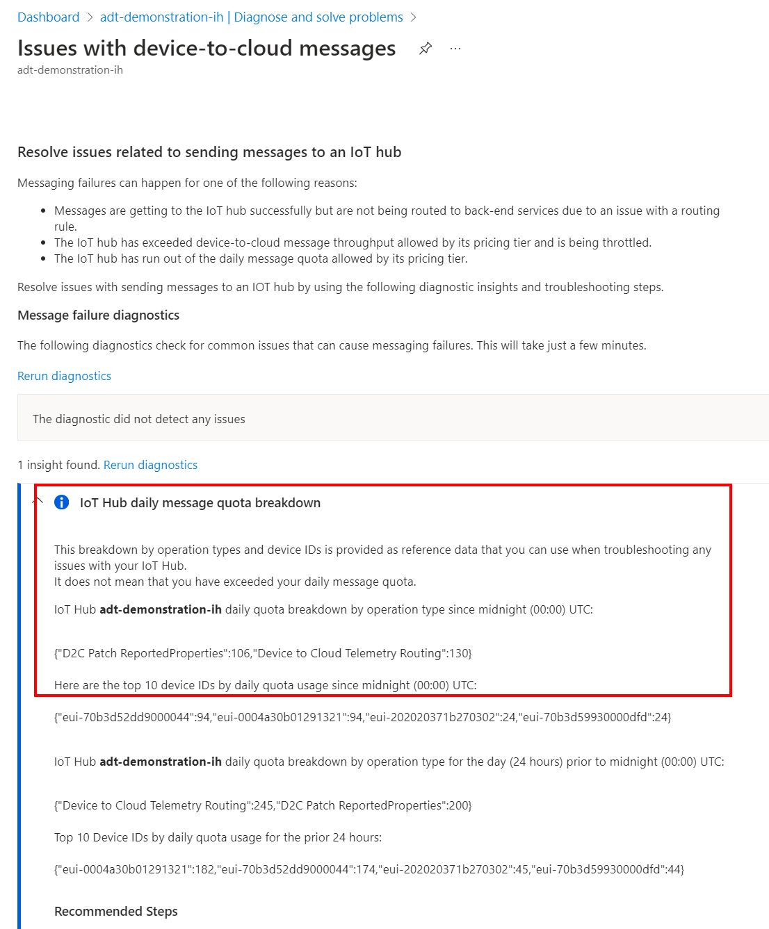

    There are some metrics in the backend available as seen in the 'Diagnose and solve problems page, Issues with device-to-cloud messages' but these are not queryable:

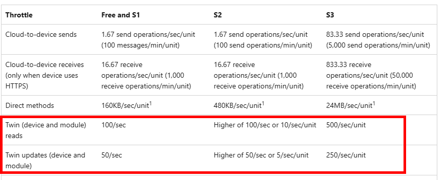

    Hi @Brian Toan , as Sander pointed, the current implementation of IoT Hub does not provide an out of the box mechanism to track the telemetry send per device. You would need to build a custom logic/implementation to achieve this. Please refer to a similar question addressed in the past where a solution has been proposed leveraging device twin property and the service SDK to monitor per device telemetry.
    Kindly be cautious while updating the device twin property frequently as there are throttling limits applied on the twin updates. Please refer the below image for reference.
    To overcome this, you may have a counter locally in your SDK and intermittently hit the device twin update end point to sync the messages sent.
    I highly appreciate it if you could propose this idea on the Azure IoT Hub ideas forum so that this feature can be upvoted by other community members looking into a similar ask. Kindly share the URL of the feature request link once it is posted so that community can upvote it.
