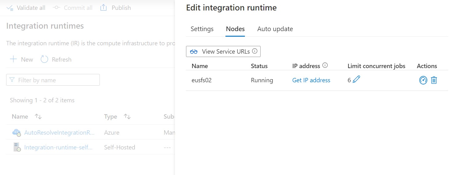

  • Data is getting copied to Azure Synapse storage from On-Prem Oracle System and one SFT server. This is done using a Self-Hosted IR

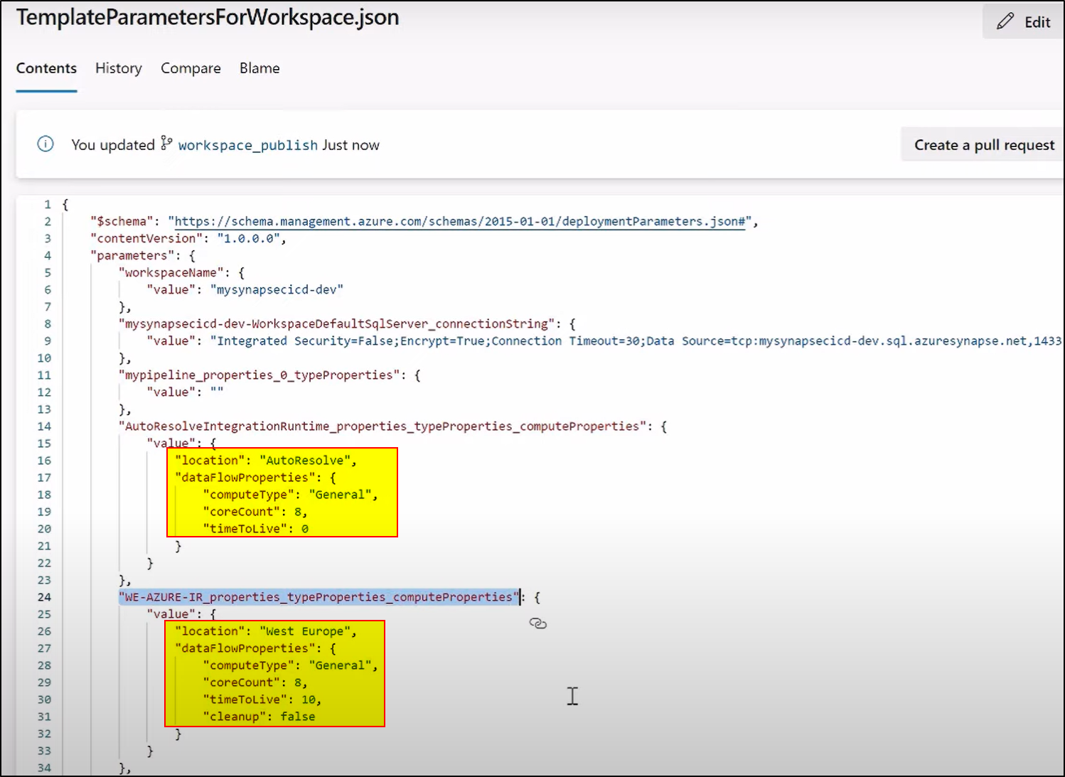

  • Now in the Work_publish folder that contains these two files: TemplateForWorkspace.json & TemplateParametersForWorkspace.json has the entries accordingly after the code gets published from the git main branch
-- This is for TemplateParametersForWorkspace.json
"LS_Oracle_IFS_properties_connectVia_referenceName": { 			"value": "Integration-runtime-selfhost-eusfs02" 		}, "LS_Sftp_eus_01_properties_connectVia_referenceName": { 			"value": "Integration-runtime-selfhost-eusfs02" 		}
