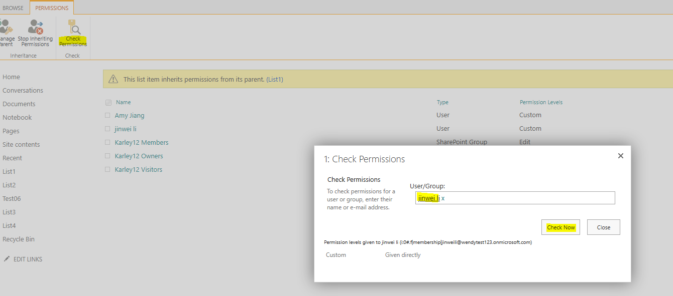

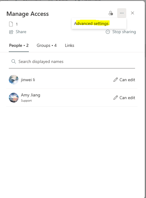

    Question 1: If we try to open a document, we're getting a 403.
    Usually, the 403 error is because you lack the relevant access permissions.
    1.Please contact your external site administrator or external site owner to check your permission for this word document. Make sure you have at least the read permission level.
    Please follow the steps below to check the permissions of a document.
    2.Please contact your external site administrator or external site owner to try regaining permissions for you.
