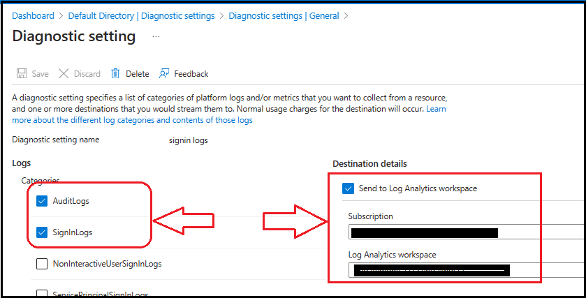

I've made sure that the diagnostic setting is set to SigninLogs and AuditLogs and being forwarded to my workspace (I only have 1 workspace).

    1. Ensure that you are reviewing logs in the correct workspace and the time filter is also correct. There are services in Azure which allow for creation of LA workspace when being created. Therefore, even if you have not created the LA workspace explicitly, there might be a chance that another workspace got created as part of some other resource creation. To examine the correct LA workspace, please check the Diagnostic setting in Entra ID and note the resource group and LA woskapce being shown here:

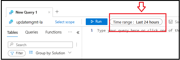

    1. When running the query in LA workspace, check the "Time range:" option set in case the logs were not generated in the scoped time period:
