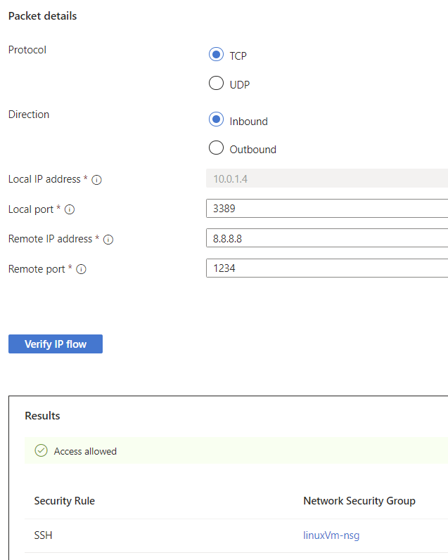

KapilAnanth • 49,866 Reputation points • Moderator2023-12-21T05:32:23.0866667+00:00 Welcome to the Microsoft Q&A Platform. Thank you for reaching out & I hope you are doing well.
- Are you using Azure VPN Gateway P2S?
- You can use IP flow verify overview tool to check if NSG is blocking requests from different IPs (other than your local PC).
Local IP Address : VM Private IP Address
Local Port : 3389
Remote IP Address : 8.8.8.8
Remote Port : 1234
Cheers,
Kapil

2024-01-02T09:04:55.1866667+00:00 - IP flow verify overview works and access is allowed

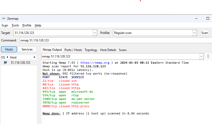

MotoX80 • 37,346 Reputation points2024-01-02T14:40:49.1766667+00:00 Nmap shows that 3389 is open on 51.116.128.123. I ran mstsc.exe and it connected. I tried to log in with user xxxxxxxxxxx so you should see that failure in your security event log.
It would appear that you have some client side issue.

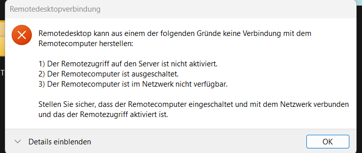

2024-01-03T11:46:27.4233333+00:00 @MotoX80 They are always geting this error message when trying to connect via mstsc.exe.
I also disabled the firewall on both sides: client and server. My colleagues tried to login with and without vpn but failed too.
They can browse internet web sites...
KapilAnanth • 49,866 Reputation points • Moderator2024-01-03T13:50:05.7+00:00 From the looks of it, this does not look like a network connectivity issue at all.
Instead, user authentication issue.
So, I am thinking firewall and NSGs are not the culprit.
If you try to login from a different IP and same Username/Password (yours), can you check if that works or fails?

Nmap is showing that you have 4 ports open.
