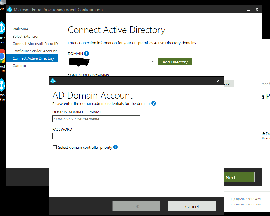

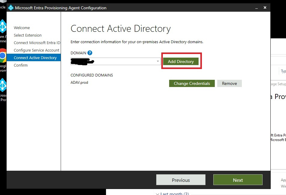

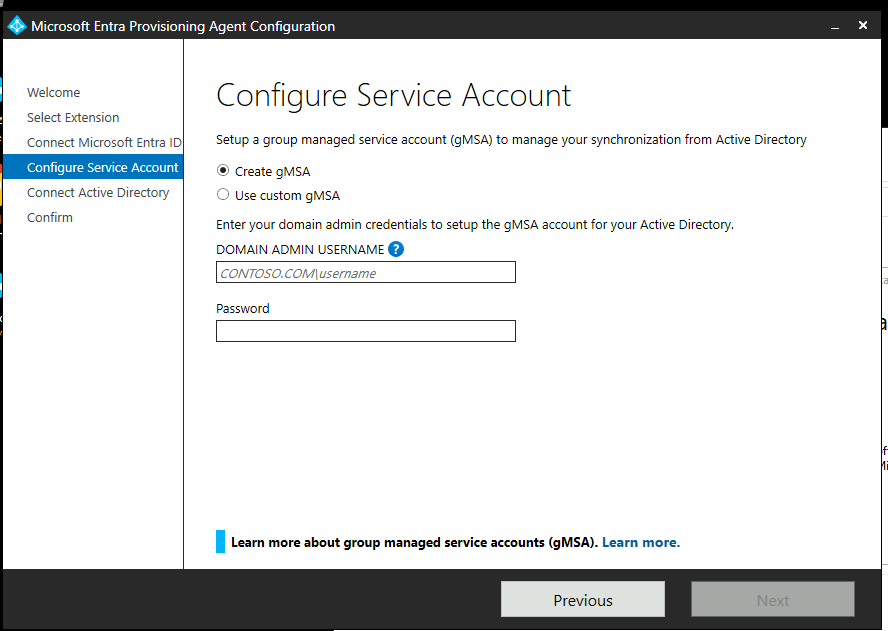

    To get the domain name in configuration blade need to validate the Service Account in the Entra cloud sync provisioning agent configuration tool with the on-premise administrator credentials. which shows in the below screen shots.
    Step-1Service account-1
    Step-2
    Service account-22
    Step-3
    Service account-3
