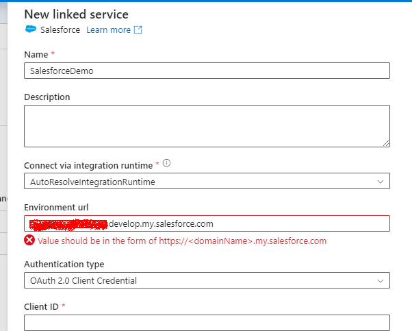

Hi, I am trying to create a linked service in Azure Data Factory for Sales Force Marketing Cloud. I have necessary clientid, client secret and subdomain(28 character key) to connect to salesforce marketing cloud. But when I test my connection on the new linked service I am seeing following error. The value of the property '' is invalid: 'The remote name could not be resolved: ''. We did required setting in the sales force as well, Could you please help me with this problem ASAP. Thank you

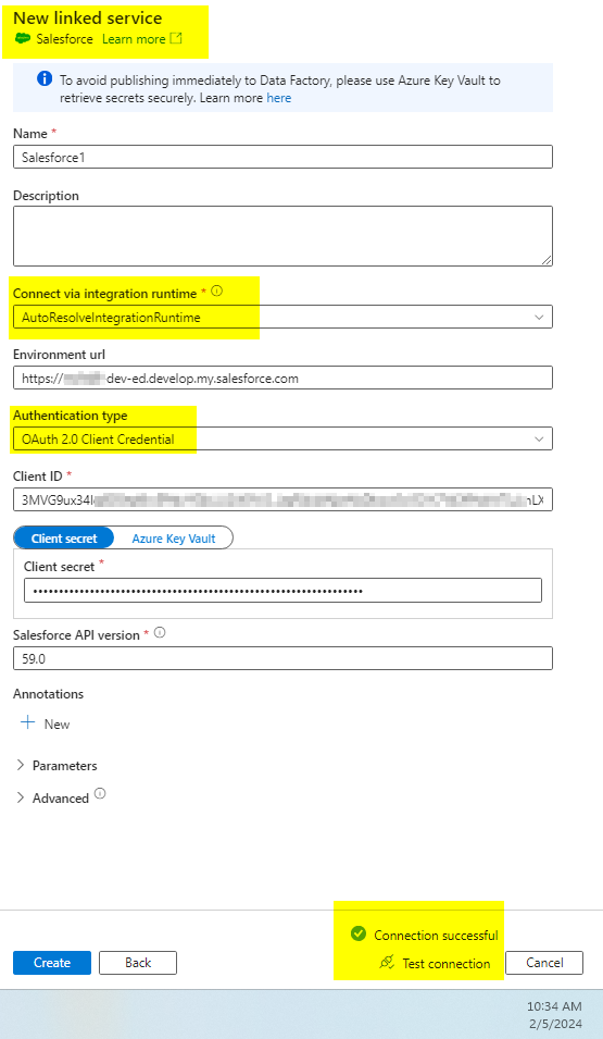

2024-02-05T18:43:46.13+00:00 @Vanama, Sai Shantan
Serrano, Carlos,@Amit Ambure Hello all, The Salesforce Connector can be verified now, please confirm the same from your side. Thanks for your patience and cooperation in this matter.Similar Thread:
